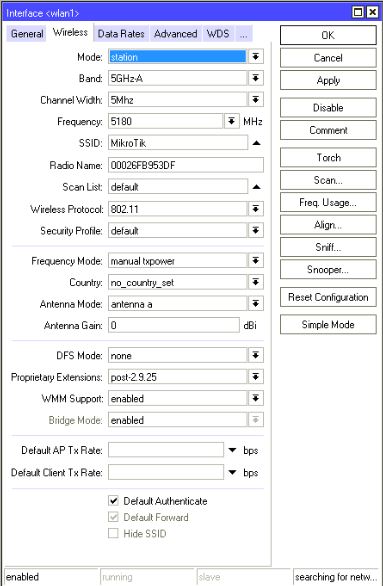

Hi, I’m a beginner user with Routerboard 411AH, I purchased an Atherous AR5413 for the wireless card and connected a 9db antenna. My LAN port is giving me Rec/Sen data packets but no matter what I do I can’t get my Wireless network to broadcast..
Anything I’m missing? I have ‘enabled’ the device.
Thanks in advance.

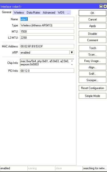

I hope this is something like your looking for?
Sort of. Text exports work better - check out the wiki manual on “configuration management”.
That said your screenshots do show what is wrong. First you should set a country so you are sure to comply with your regulatory domain. Not doing so doesn’t make the cops come on over, but it would potentially have you be a bit of a dick inadvertently interfering with all kinds of stuff.
The main issue is that you are in station mode - your radio is trying to associate with other APs, just like a laptop it is being a client. You want to change that to ap-station so it’s acting as an AP.
