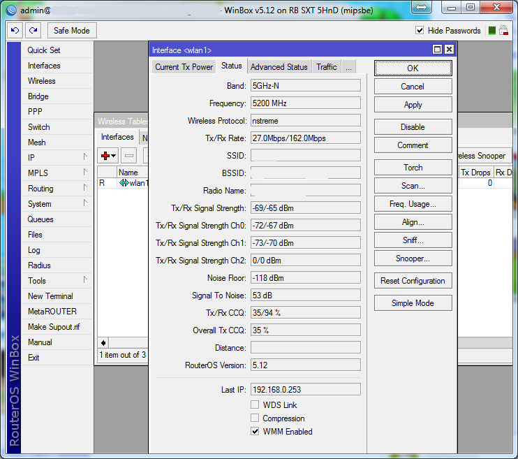

Hi Everybody,
i have a link with two SXT’s but i have a very weak TX-Signal.
I use nstreme with the best results. NV2 broken down.
What can i do?
With other Frequencies the rest doesnt better.
Hi Everybody,
What can i do?
upgrade os i had problems on wireless side with 5.12 i upgraded to 5.13 and 5.14 and worked better then 5.12
on the ap side but your probly osing it in bridge mode
I have upgraded, but the same problem. I have another link with 5.12, nstreme and 6,5 km distance with 90% CCQ.
Have the Antennas (SXT’s) a problem?
Whis is a anntena of environment problem. Maybe channel change will help
dont use any of those protocols just use 802.11, you could get better link, i has worked for me before
Its probably caused by interference in your area. Do you spectrum scan and find another channel with less noise.
/interface wireless spectral-history wlan1 range=5ghz
After you have done that try using NV2 as it should maximise your bandwidth.
