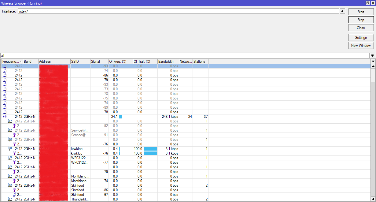

How about using wireless snooper? I’m not able to export the wireless snoop stations records into file.

You look in the frame of the wireless packet and you will see MAC addresses. Devices are constantly looking for known SSIDs to connect to and send out Probe requests to determine if those SSIDS are nearby. You can capture those and get the required information.
You can also track associated clients but looking the ACKS that are flying through the air, and find access points by looking at the beacons.
All this data is flying through the air all the time, and is ripe for the picking.
Mikrotik is not the best kit to do this due to the limited API control of the snopper / sniffer ; but look at openWRT has tools to grab this and write it all out to a CSV.
TheWiFiGuy is right, it’s possible using wireless sniffer.
The only “problem” with that solution is that when wireless sniffer is active, radio can’t do anything else, so you need 2 radios if you want to sniff and provide WIFI. But seen the price of Mikrotik gear, you will be anyway far far below cisco prices ![]()

Try this… the resultant file "sniffer.cap"can be viewed in Wireshark and shows mac and signal strength. I couldn’t set the duration of the test (interval only allows up to 5 seconds) so some trial and error required.
[admin@test] /interface wireless sniffer> sniff wlan1
append as-value do file interval once without-paging
[admin@test] /interface wireless sniffer> sniff wlan1 do=
processed-packets: 1529
file-size: 10204
file-saved-packets: 39
file-over-limit-packets: 1490
memory-size: 10198
memory-saved-packets: 34
memory-over-limit-packets: 1495
real-file-limit: 10
real-memory-limit: 10
[admin@test] /interface wireless sniffer> packet print file=sniffer.cap
Try this… the resultant file “sniffer.cap” can be viewed in Wireshark and shows mac and signal strength. I couldn’t set the duration of the test (interval only allows up to 5 seconds) so some trial and error required.
file-size: 10204
memory-size: 10198
real-file-limit: 10
real-memory-limit: 10[admin@test] /interface wireless sniffer> packet print file=sniffer.cap
