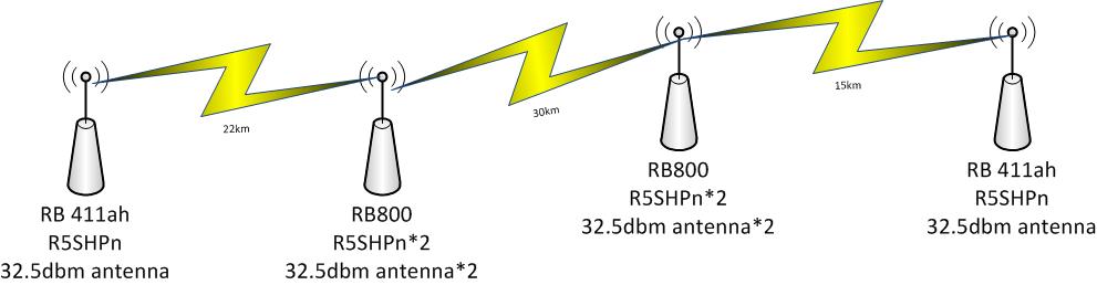

i have wireless topology like above figure:
i have over than 100Mb UDP and over than 60Mb TCP bandwidth per link , but when i use bandwidth test over all links my bandwidths are 50Mb UDP and 20Mb TCP
what is the problem???

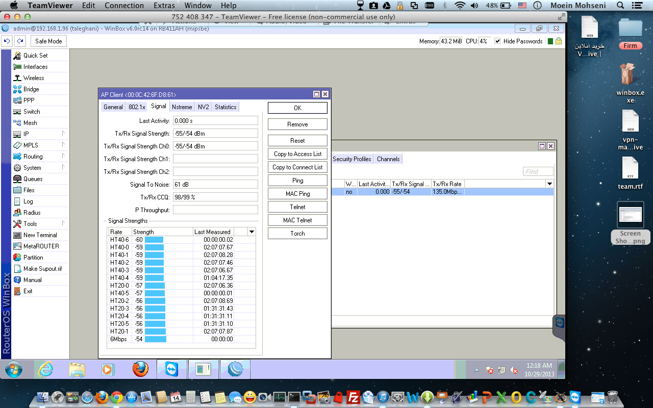

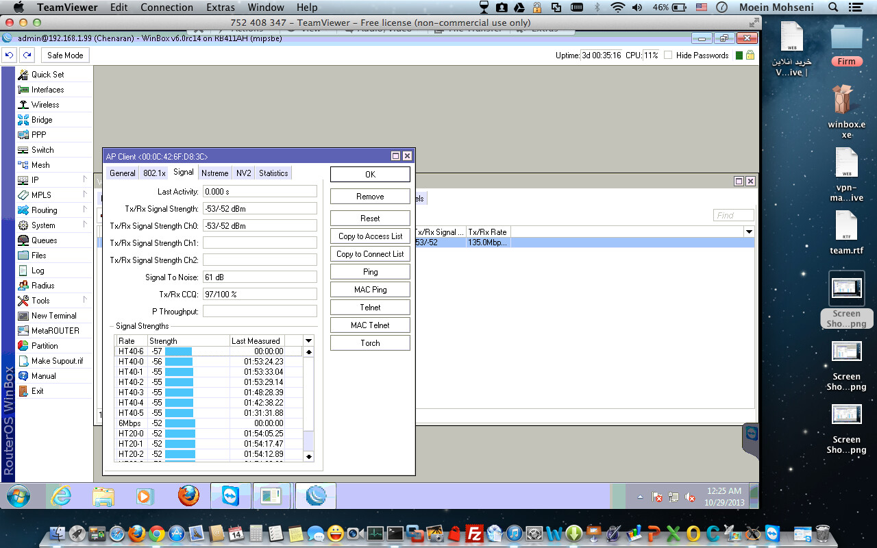

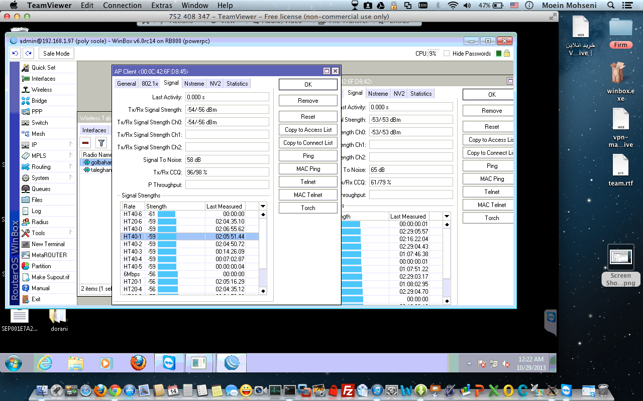

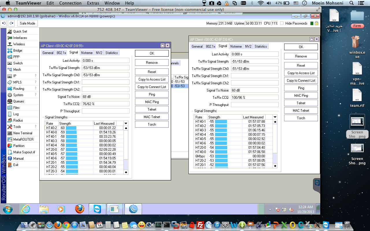

Could you upload photos of the signal strenths and Tx/Rx CCQ of EACH Link?
yes :slight_smile:
:slight_smile: :slight_smile: :slight_smile:
all router configured to:
station bridge
router os 6.0rc14
frequency mode are superchannel
wireless protocol nv2 family
and in all links Nstreme enable with best feet frame policy

In the first one and in the second one photos, you have problems with CCQ.
Can you fix them with MANUAL fixing the MCS config?
i fixed it, i have very noise in this link
