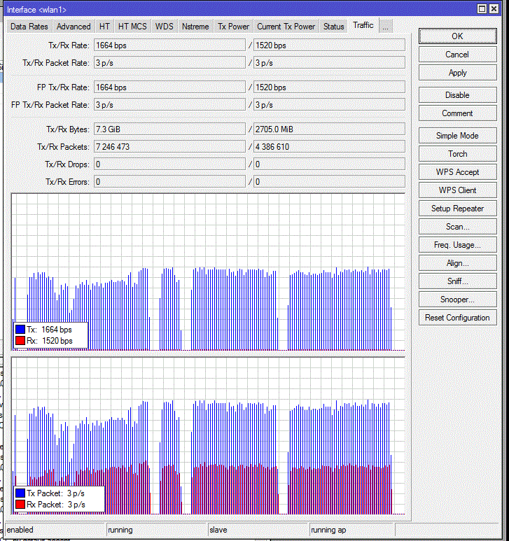

The problem: using iperf and downloading on PC2 I get occasional dropouts. Here is the picture from MIKROTIK1:
They are not periodic, but they usually last ~5sec.
The funny thing is that if PC2 is connected to MIKROTIK1 (i.e. not using repeater), I get the same picture. And if I look at MIKROTIK2 at the same time, I see some minor “broadcast” traffic going on at ~100kbps, and that traffic is also interrupted at the same time when dropouts happen. It seems that MIKROTIK2 in repeater mode is causing some interference.

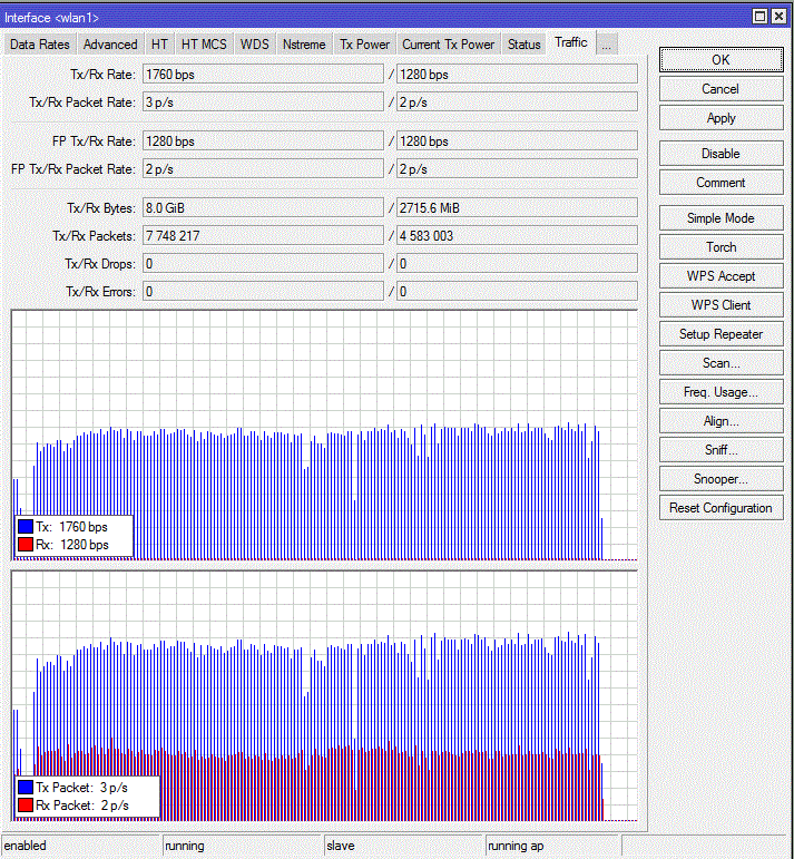

If I turn off MIKROTIK2, I get nice constant traffic:
