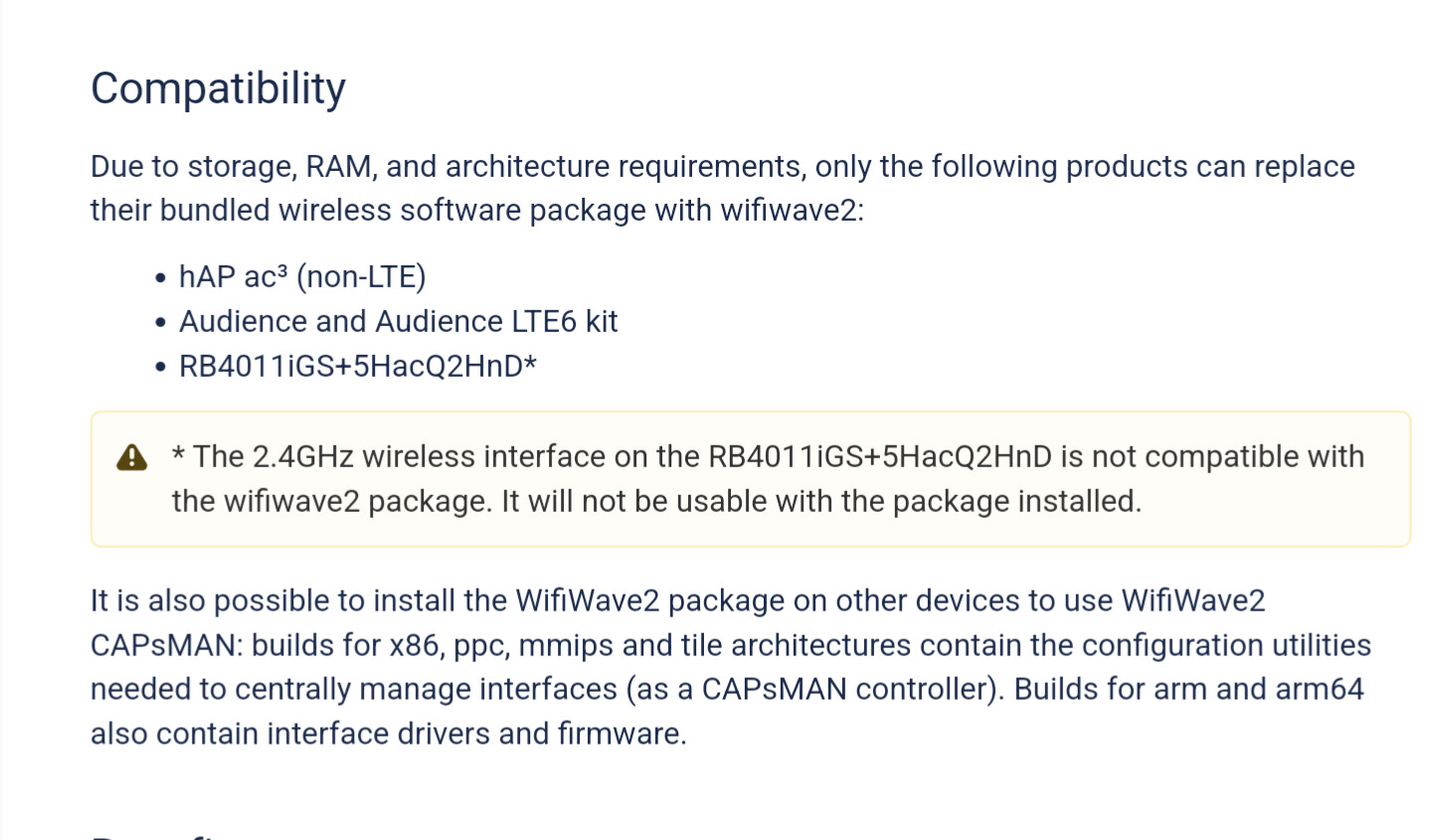

I read that wifiwawe2 is implementing 802.11r/k/v that can solve this problem, but im not sure is the HW i owe is supporting that.
on the manuals only states that i cant replace stock wifi package but i may be able to sideload the new one for using some CAPsMAN features.
Compatibility
Due to storage, RAM, and architecture requirements, only the following products can replace their bundled wireless software package with wifiwave2:
hAP ac³ (non-LTE)
Audience and Audience LTE6 kit
RB4011iGS+5HacQ2HnD*
  • The 2.4GHz wireless interface on the RB4011iGS+5HacQ2HnD is not compatible with the wifiwave2 package. It will not be usable with the package installed.
It is also possible to install the WifiWave2 package on other devices to use WifiWave2 CAPsMAN: builds for x86, ppc, mmips and tile architectures contain the configuration utilities needed to centrally manage interfaces (as a CAPsMAN controller). Builds for arm and arm64 also contain interface drivers and firmware.
Fonte: https://help.mikrotik.com/docs/pages/viewpage.action?pageId=46759946#WifiWave2(7.12andolder)-Replacingstockwireless
Can anybody better explain this?
thanks
Lorenzo

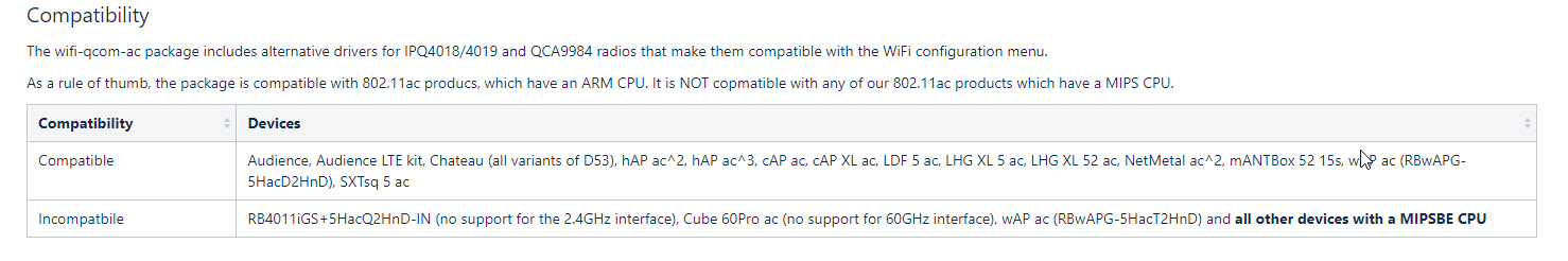

yes it seems to be compatible in 7.13beta
Compatibility
The wifi-qcom-ac package includes alternative drivers for IPQ4018/4019 and QCA9984 radios that make them compatible with the WiFi configuration menu.
As a rule of thumb, the package is compatible with 802.11ac producs, which have an ARM CPU. It is NOT copmatible with any of our 802.11ac products which have a MIPS CPU.
Compatible Audience, Audience LTE kit, Chateau (all variants of D53), hAP ac^2, hAP ac^3, cAP ac, cAP XL ac, LDF 5 ac, LHG XL 5 ac, LHG XL 52 ac, NetMetal ac^2, mANTBox 52 15s, wAP ac (RBwAPG-5HacD2HnD), SXTsq 5 ac
Incompatbile RB4011iGS+5HacQ2HnD-IN (no support for the 2.4GHz interface), Cube 60Pro ac (no support for 60GHz interface), wAP ac (RBwAPG-5HacT2HnD) and all other devices with a MIPSBE CPU
but i cant find any information regarding the procedure to uninstall the ‘wireless’ package, then install ‘wifi-qcom-ac’, can someone please explain that?
and, shoud i do this also on the routerboard where CAPsMAN is running?
