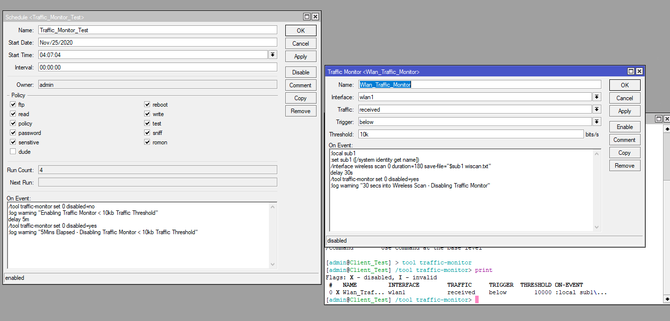

Ok work in progress ! ( I assume someone will say there is a easier method, If so please let me know!)
Just testing one possible solution,
Here is the workflow
(1) 04:07:04 will enable the disabled Traffic_Monitor
(2) if traffic flow is below 10kb - run wireless scan
(3) 30 seconds into wireless scan - disable traffic-monitor ( to prevent scan loops! )
(4) 5mins after scheduler task started - scheduler disables traffic-monitor (this to ensure max time traffic monitor can remain active is 5mins - once again preventing scan loops!)
