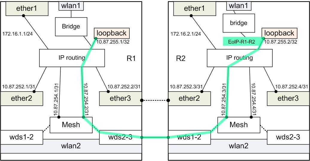

I tried to build a network with OSPF routing at L3 and mesh with default settings at L2 (scheme attached) but it becomes unstable after a few minutes of work (WDS connections remain live). What could it be? I plan to remove mesh and attach its IP addresses to WDS interfaces directly. Whether the mesh is useless in my case?
I assigned IP addresses to WDS interfaces instead of mesh, it became more reliably in static mesh mode.
As seen in picture from previos post, my routers have two WDS connection with their neighbors. I don’t need to these interfaces have been bridged because I use L3 routing over them.
If WDS connections must be a ports of mesh or ordinary bridge even so? When I set default bridge=none in wlan interface settings it doesn’t work.

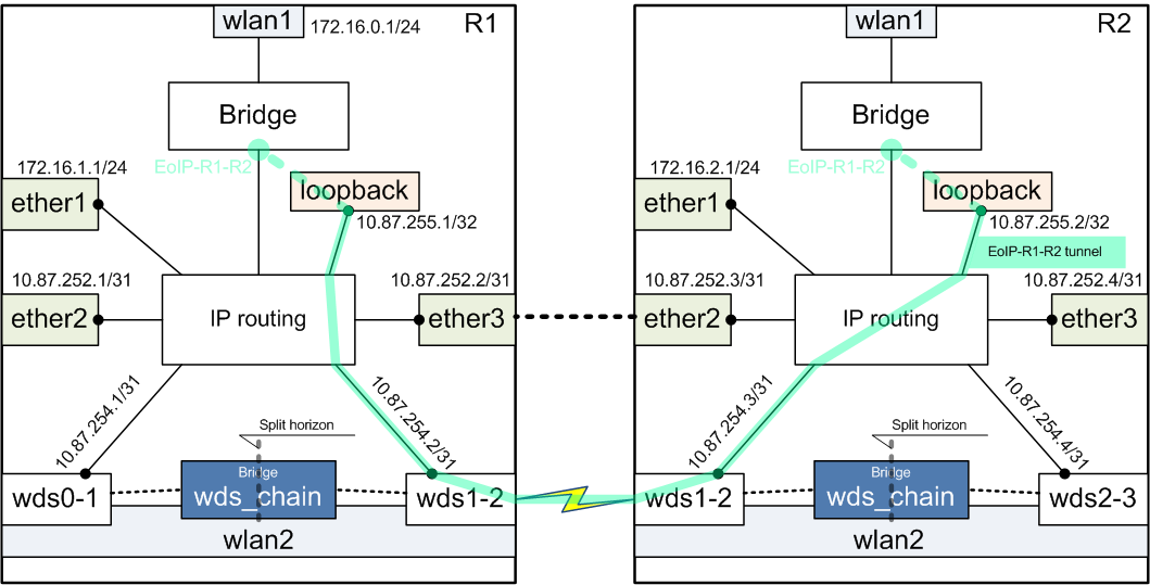

I don’t need bridging because of using OSPF routing over wired and wireless channels between routers. I place AP traffic into EoIP tunnel and pass it over WDS because there is no adhoc mode in MT.
Now my network works as shown on picture here. Sometime disconnection happens (it takes about 5% of channel operating time). I increased the “hw retries” and “Disconnect timeout” but it remains. Wireless debug logs are the same as above. RSSI is about -55…-75 dBm.
What could be the reason?
