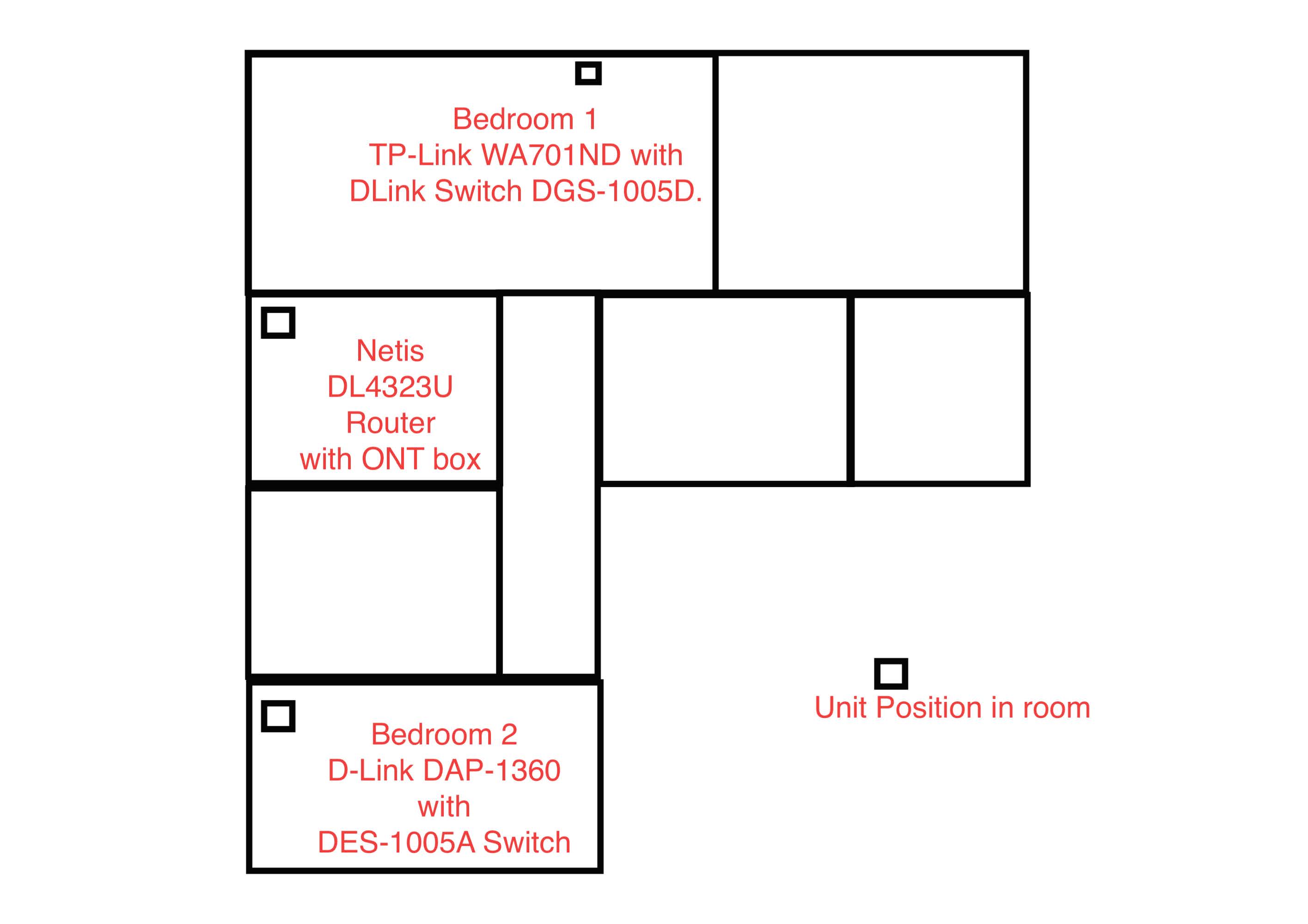

Hey Philip, walls out of brickwork. 2 floors in L Shape. Each floor roughly same being approx 300 square meters. I have attached a pic for reference of the second floor. The ground floors bedroom setup is directly below bedroom 1 setup on 2nd floor.

Ok, so all of the inside walls are brickwork, which will make 5Ghz a bit of a challenge. Which box is your networks router, is it the Nokia ONT or the Netis DL4323U?

One thing I would do, is get a free WiFi analyzer program and see what your signal levels are from various spots in your house. If you have too many AP’s, they will fight over channel space and make your connections unreliable.

Well researching your network gear and knowing your setup now, your biggest choke point is your Netis DL4323U9 router and the 100Mb switches are the second, with the AP’s being the third. With a connection of 200Mb down/100Mb up, 100Mb Ethernet will bottle neck your 200Mb speed, so you will need to go 1Gb on the trunk of the network.
The DL4323U9 LAN ports are only 100Mb (4* 10/100Mbps Auto MDI/MDIX RJ45 LAN Port) and the it looks from the reviews I have seen, the firewall throughput is good only to 50Mb or so. I would replace this with a Hex Router or a Hap ac with 1Gb ports. I would also look at getting 1Gb switches to replace the 100Mb ones you have, but this is if you plain on keeping the same topology.
An app like Acrylic Wi-Fi will let you see if you can see all of your AP’s through the house before you buy faster ones. You might find that you only need two AP’s at each end of your house to cover it, which will lower the cost of the network upgrade.
If you wanted to stay with the same network topology that you have now, I would replace the Netis DL4323U9 and all of the switches and AP’s with 3 Hap AC’s. One would be the router/AP/Switch, the other two would be AP’s/switches. If it turns out that you can get buy with two AP’s, I would do a Hex router and one RB260GS switch with the ONT and two WAP ac or CAP ac AP’s. Then in the rooms that need switches, I would put a RB260GS switch in them and connect them back to the switch that is with the Hex router and ONT.
