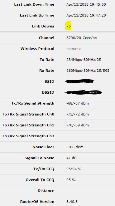

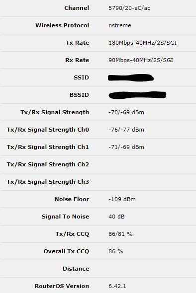

Very new to this but wanted some advice, my connection is dropping out frequency over a 5k LOS link, with the log showing Large Data Loss detected and the wireless link is reset each time.
From the attached screen shot would this signal strength and noise floor figure look ok, or would they be considered to low for a reliable signal.
Changed protocol to NV2 (from nstreme) makes it a bit more stable but drastically reduces throughout.
Was looking at increasing the period size to 10 on NV2 but then latency goes up by a factor of 5x
Its a point to point with 2x SXTG-5HPacD radios
Any advice is welcome, maybe a better protocol config or am I looking at a new radio with bigger aerial?

Mikrotik calculator says link is unreliable. Probably better to get https://mikrotik.com/product/lhg_5_ac

I will check out the new radio you mentioned, as that might work better with my existing link based on distance and noise floor level?
