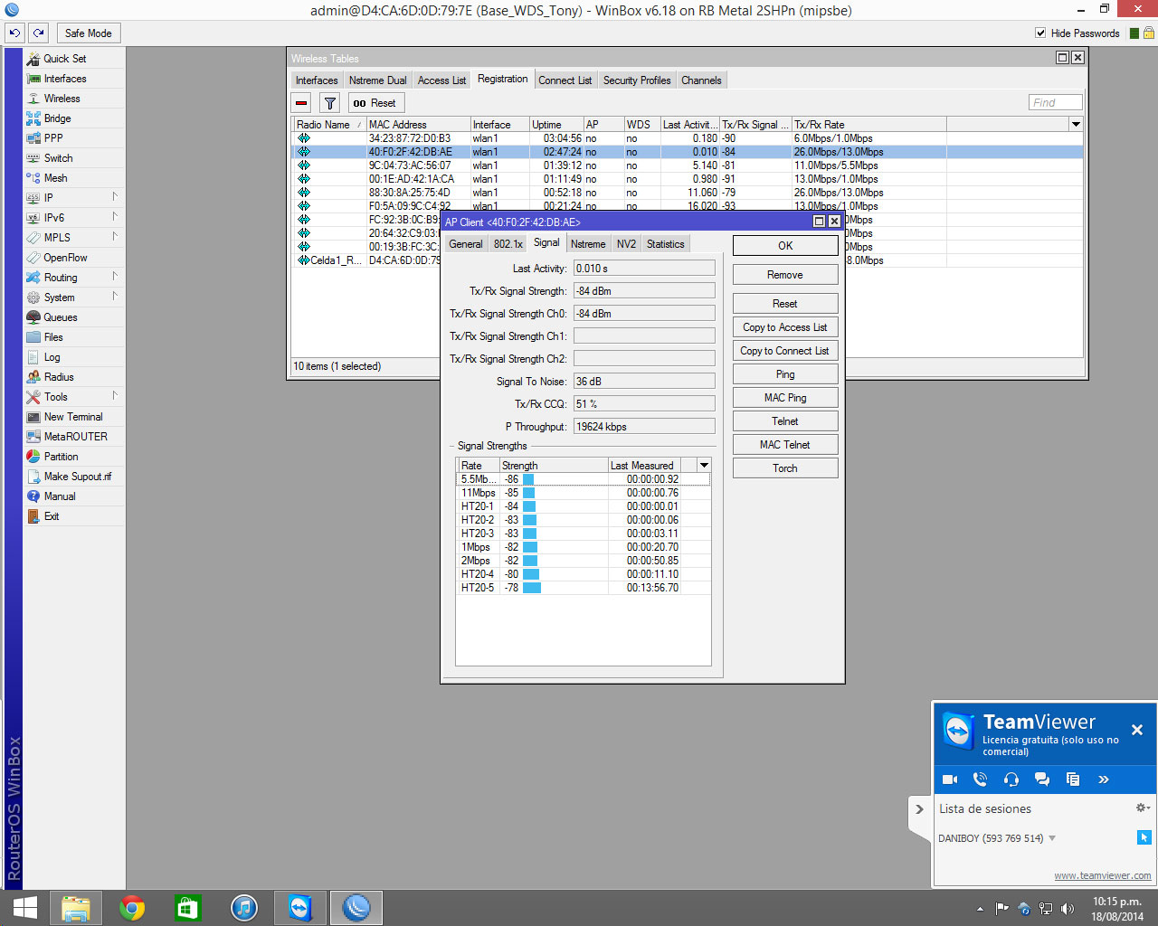

I have a question for you… I have been seeing people connecting with -80s and still get a good CCQ… above 30s… Now if i set the signal limits to -70 this users that actually seem to have a good connection wont be able to connect and this means $$. Its CCQ the best way to rate signal communication???
I tried this: http://wiki.mikrotik.com/wiki/Force_Disconnect_Wireless_Stations_with_Low_CCQ but for some reason it disconnects all users, even the good ones!!
Can you or anyone else advice on what I should do in this case?
As I grow I think this issue will go away since there will be on groove metal every 80-100 meters, but I still want to be able to offer a great service and not have the issue if someone inside a concrete wall room with a small window gets the signal mess it all up for everyone else…
I have attached an image of what I am seeing..

50% is still a low ccq. I have not tried this script about ccq, but as I read it - it should work.
