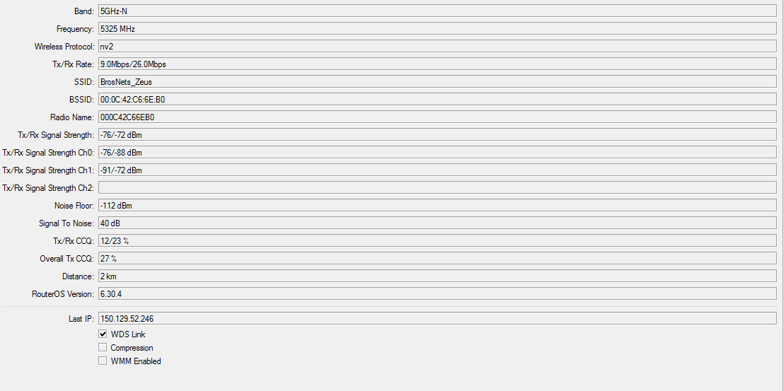

why tx/rx for both the channel have lot of difference?
How to configure it?

However, one thing that stands out to me is that you have a large disparity between the two chains - which leads me to believe that there’s a polarization issue in your installation.
Furthermore, out of the 4 tx/rx values shown (chain0 and chain1), only one of them is above the rx sensitivity required for MCS7 modulation rate. You should double-check the antenna alignment and the cabling between the radio and the dish.
~25% CCQ is abysmally bad - which means that you’re getting lots and lots of failed transmissions. Part of this is probably due to the fact that your signal strengths are below the threshold for good modulation, and the radio is probably going through repeated cycles of attempting to use faster modulation rates, getting too much errors on those rates, slowing down, improving, and attempting to speed up again.

let me check with alignments. Actually I have been using UBNT before this so i am practicing this connecting 1 device.
AP is MaNT19dbi Sector with basebox 5 and Client end is SXT Lite5.
