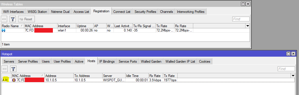

I’m having some difficulties in reopening the Captive portal of the hotspot on the devices, once the user authenticates it’s also presented in the Wireless interface at (Wireless Tables > Registration)
![[Attachments 1].png](https://data-discourse.cdn.mikrotik.com/original/3X/f/c/fc2c7a282115703e546bc1a23309cdb06a1e5efe.png)

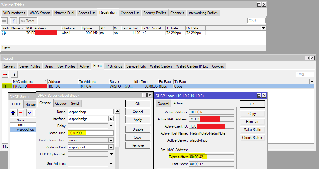

However, once the session is terminated by the RADIUS, it’s still in the Wireless interface and the Captive Portal doesn’t reopen.
Here in the case it dropped by (Session-Timeout), 1 minute of session due to the test.
![[Attachments 2].png](https://data-discourse.cdn.mikrotik.com/original/3X/6/c/6c2f27a4d38f4f96e74dc380726a7be8546246b2.png)
DHCP Leases was also kept at 1 minute.

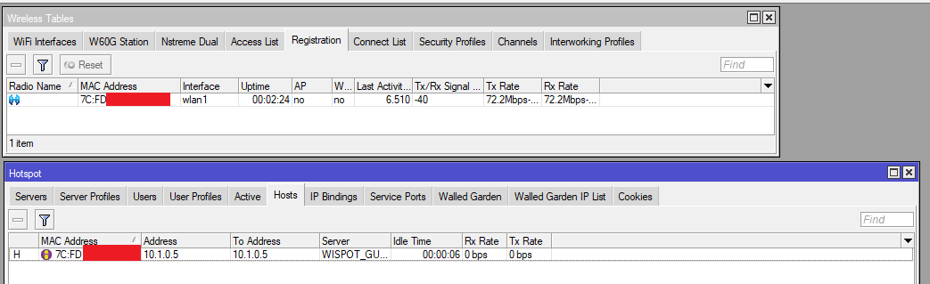

![[Attachments 3].png](https://data-discourse.cdn.mikrotik.com/original/3X/e/0/e0259e23d7f96fbc7cfb3203f757890b348ba6fc.png)
It happens that if the DHCP Leases is kept at 1 second, the Wireless Interface will fall, but the device will have its session terminated ahead of schedule, that is, the user will fall through Lost-Carrier in Termination Cause, Therefore, I would like to know a way for the device to be disconnected from the wireless network once the session is terminated by RADIUS, the case also impacts on a network where the Wireless network is propagated by an Access Point, I don’t know exactly what can be done to have this disconnection to reopen the Portal.
