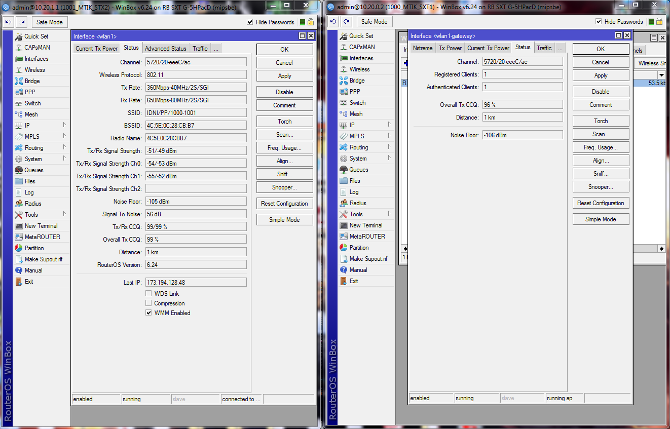

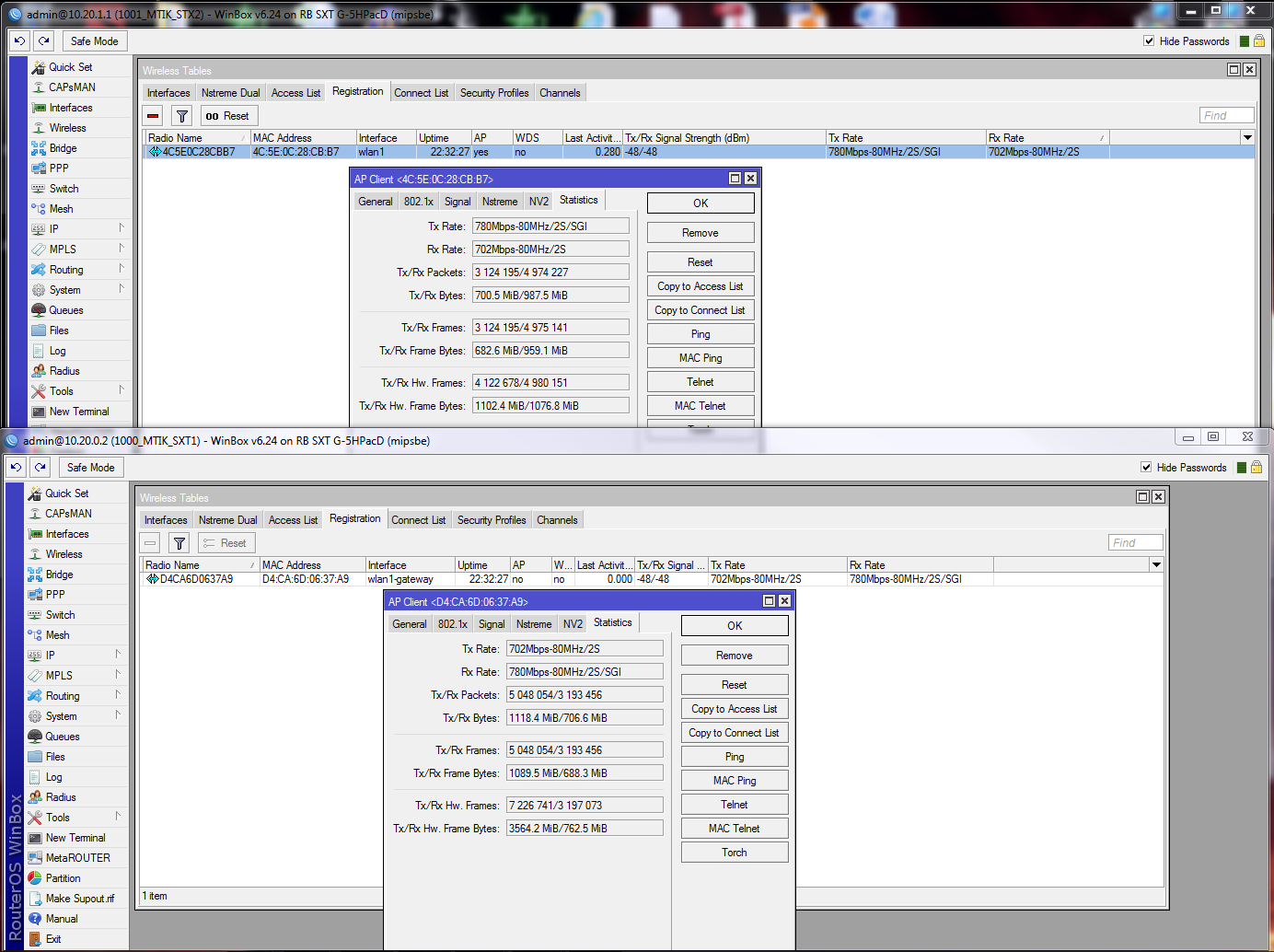

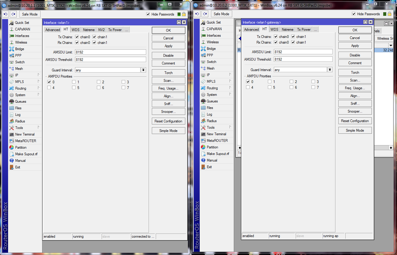

Recently I purchased 2x RBSXTG-5HPacD and connected together using 5Ghz AC. Wireless registration jumps up and down from 6mbps to as high as 780mbps, but I am unable to get anything even close in throughput (Please refer to the attached image).
I am not sure what to check, any advise would be appreciated.

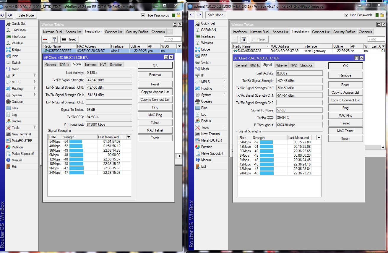

What signal levels are you getting. For best ac speed, signals should be around -40dbm and as less interference as possible in testing frequencies.

Hi kristaps,
They say a picture is equal to a thousand words, so here goes …
Just to answer your questions as well.
— Have you upgraded to latest RouterOS version ?
-YES, running version 6.24 on all devices.
— How far one form another they are ?
-The SXTs are roughly 250m apart.
— What signal levels are you getting. For best ac speed, signals should be around -40dbm and as less interference as possible in testing frequencies.
-Please refer to the above images.
— also Try not to generate traffic with btest on test board because it will overload cpu and you will get bad results.
-The bandwidth tests have been done from a desktop to a Mikrotik Switch (CRS102-8G-1S-2HnD) on the other side to the SXT link. The SXT AP is directly connected to the Mikrotik switch.
I found last night that there are periodic disconnects over the link as well. (Not good for Dota2 or Youtube) :slight_smile:
If you or anyone else has any advice on improvements that could be done to the configuration, I am very interested to hear your thoughts. I am also happy to try anything.
Thank you in advanced.

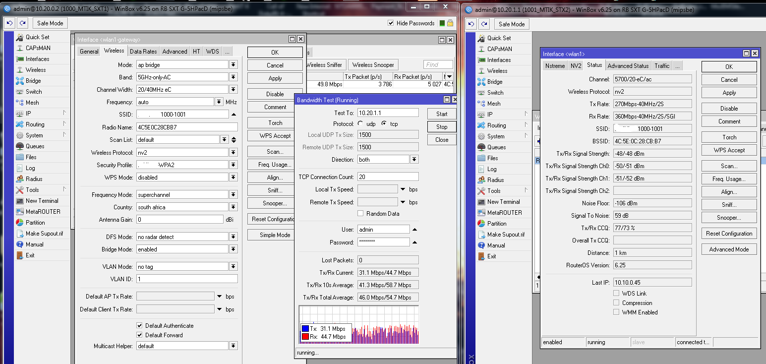

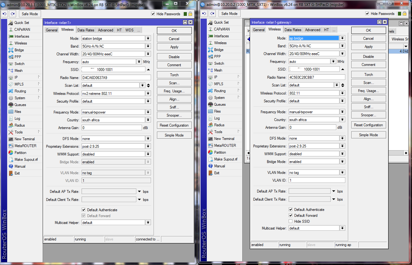

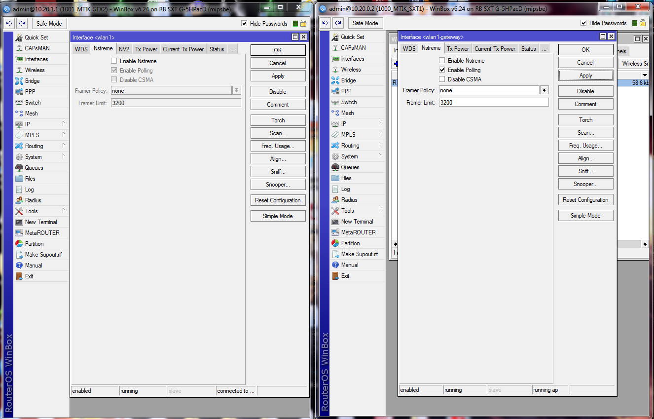

On the client side wireless protocol is set to nstreme,nv2,802.11 on AP is set to 802.11
Set wireless protocol nstreme or nv2 on AP side and any on client side

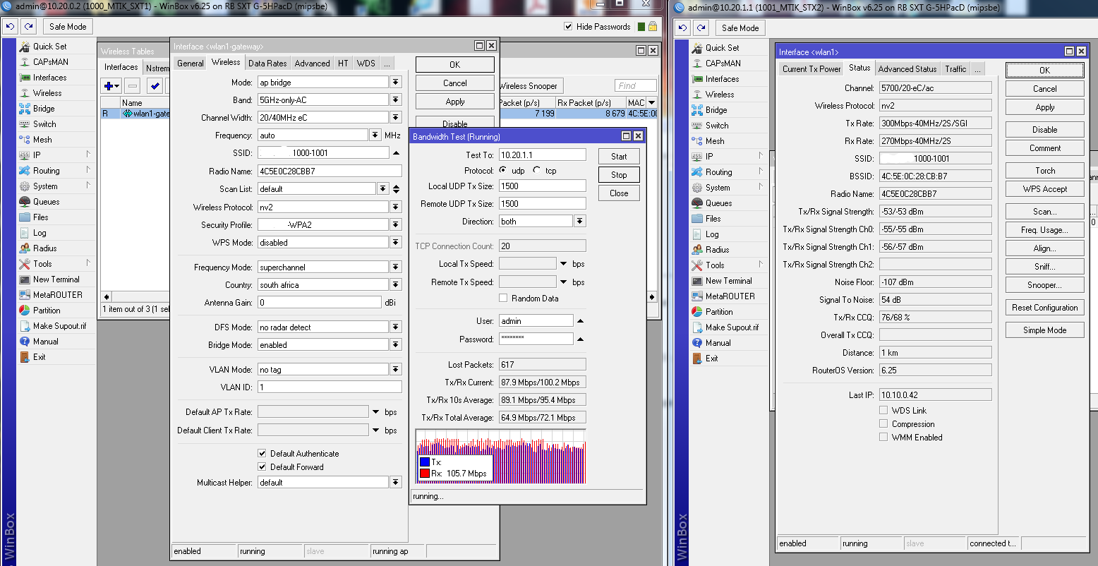

  • use NV2
  • set 40Mhz channel
  • use a channel between 5400-5500Mhz (5450Mhz is the best antenna gain for SXT ac.)
    I’m getting ~200mbps
Hi Both,
Firstly I just want to say thank you.

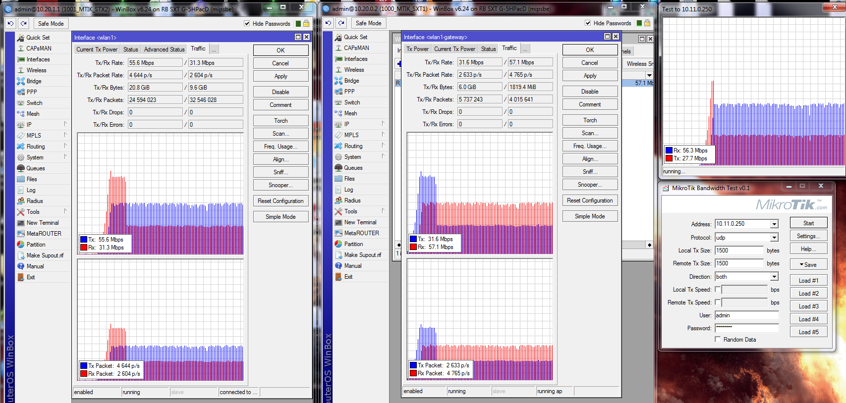

Playing around with the settings you mentioned has got me up to almost a 100mbps throughput and more importantly the link is a little more stable. I still don’t think this is close to what these devices can do over such a short distance and by looking at the CCQ % its most likely due to interference. I am strongly considering getting some sort of shielding for these SXTs. Below is a screenshot of my current settings and throughput.

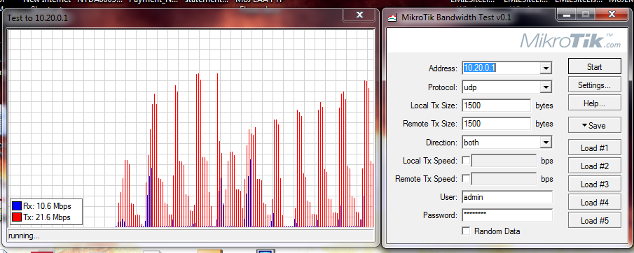

I would like to see this tests with TCP.
Hi druiah,
As requested …
Thank you Very much bro ! iwill try to do the same and post here results ! thank you !! if it is not asking too much, do you have the screenshot of one direction test ? thx

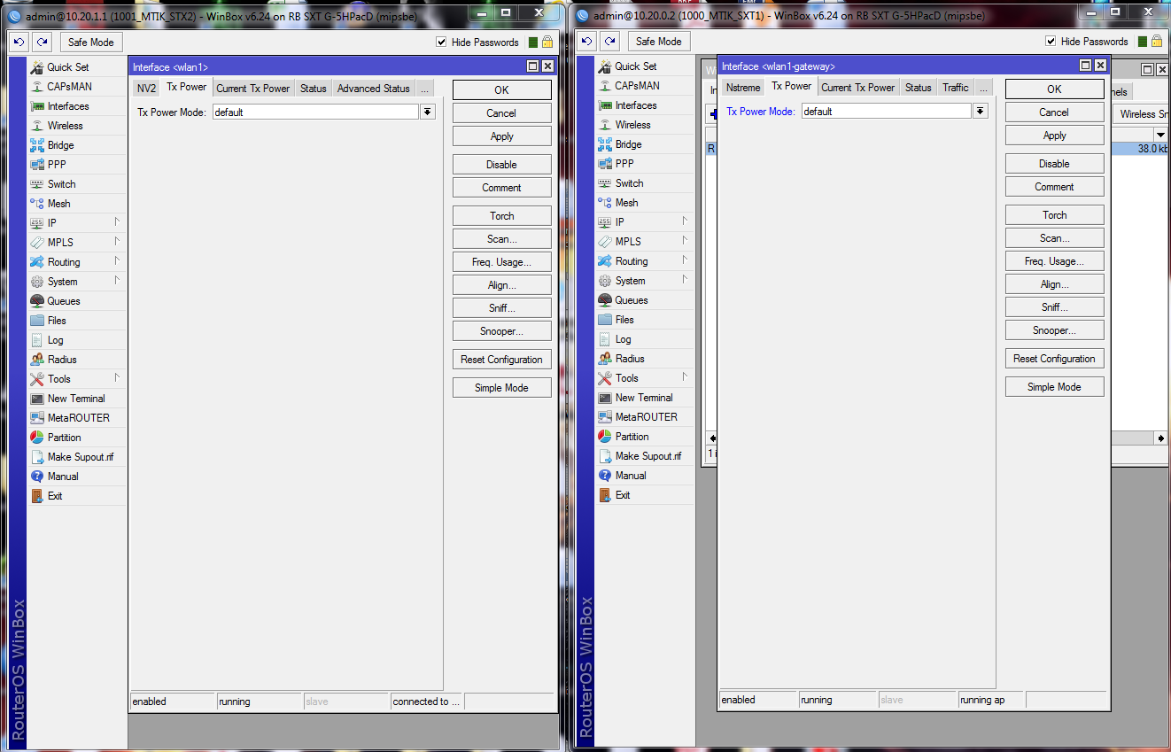

U post picture about Tx Power=default hm just look in Current Tx Power TAB its empty.
