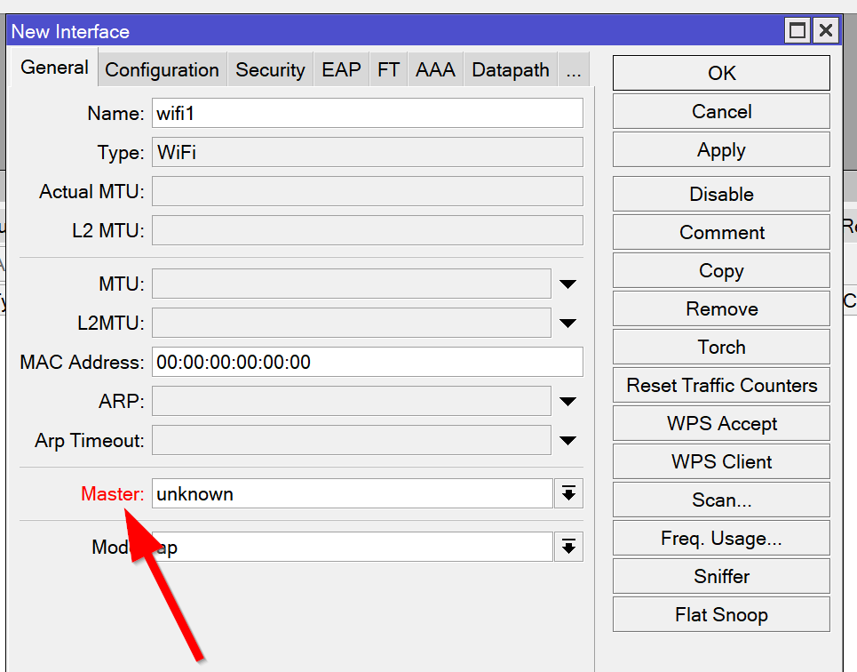

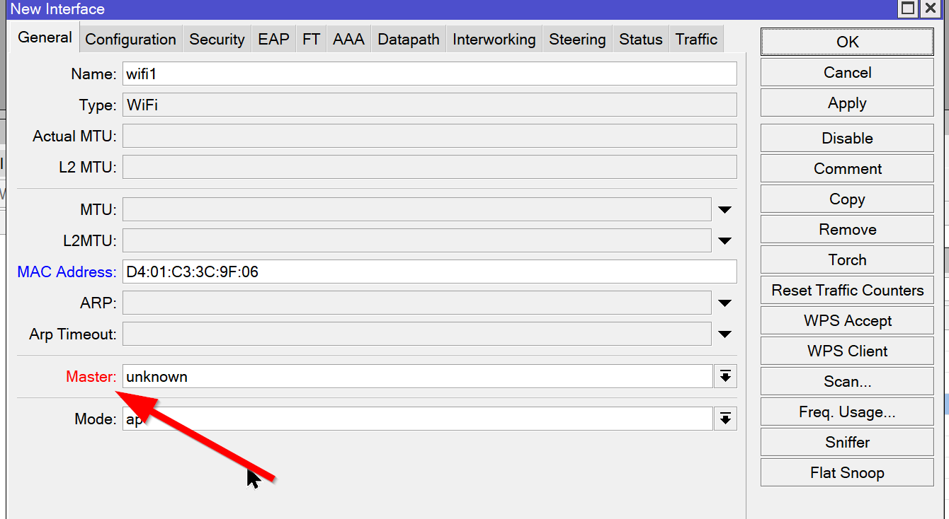

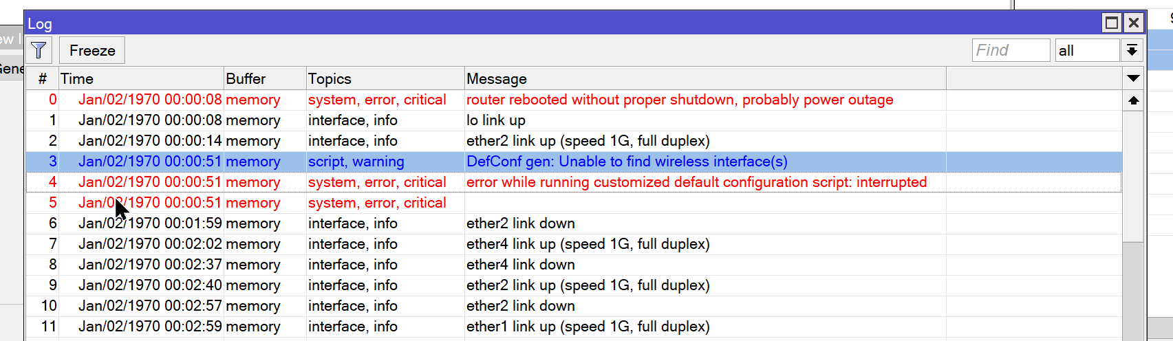

Have a Loo9UiGS-2HAxD-IN. Have had issues trying to get the WiFi operating on this unit. Since it appeared corrupted I did a Netinstall of the 7.15.2 router .npk and the wireless.npk. Have read that they have to be installed together in netinstall versus uploading the wireless file through the Files dialog. I have not been successful, despite the fact I have down this three times.
Understand that the wifi normally installs automatically. I have placed the log error that must be the clue to fixing this issue. Can anyone point me in the right direction. Is this a install script issue?

You need wifi-qcom, not wireless.npk
True. Currently, the easiest way to download the necessary packages is to find your device model on the product page and go to the “Support & Downloads” tab - find “RouterOS current release” and under the “Download” button there are all the necessary packages for the device.
https://mikrotik.com/product/l009uigs_2haxd_in#fndtn-downloads
