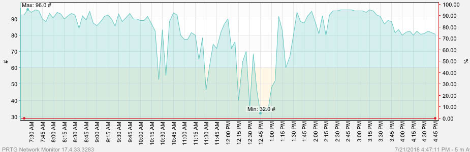

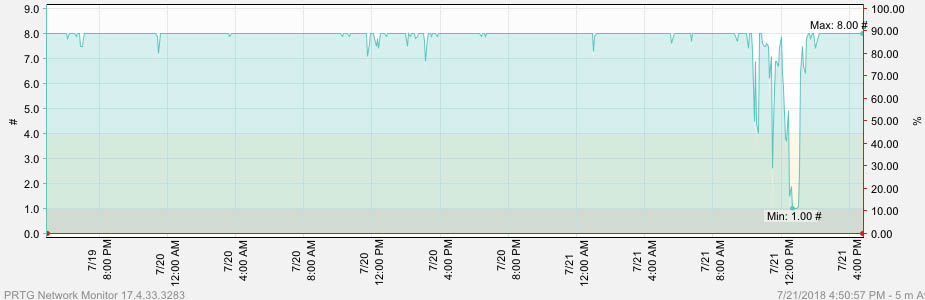

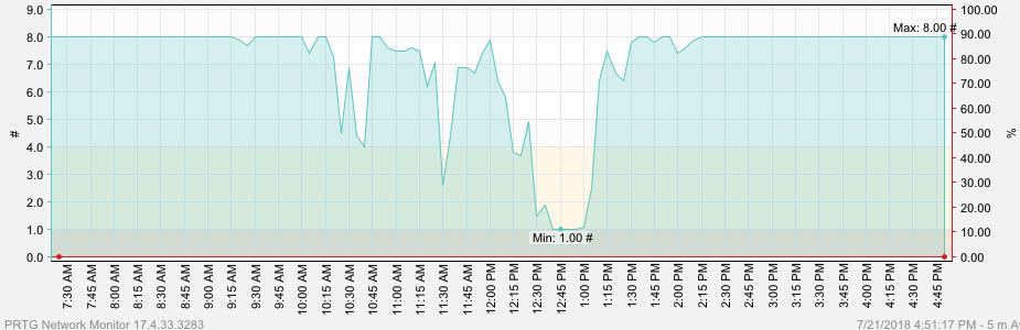

Yesterday, we began seeing further unexplainable drops in the signal strength and the MCS rate as shown in the graph below. The graphs show the “normal” activity of fluctuating between 100 and 80, but the 8-hour graph shows the drops that we just can’t explain. It wasn’t a rain-fade or weather interference. These dishes actually haven’t responded any differently to rain-fade but its a very short distance.
Does anyone have any clues as to why were seeing very low signal strengths? Or any thoughts on what could be causing these dips?
