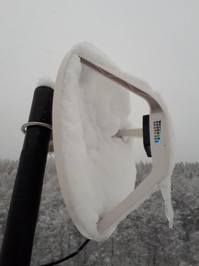

Wait for first snow. Link is not working :frowning: :frowning:
Mikrotik - Why no radom for this LHG? Snow is death for a reflective surface
We see the same on 800m with light snow fall. Seems 60GHz does not like snow. Link was down an hour. 5Ghz backup jumps in.
