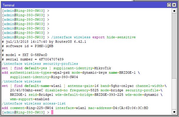

Now I have 2 Mikrotik SXT 5 AC devices for bridging two buildings but it is not stable.
Is Wireless Wire 60Ghz a good replacement for this and is het more stable?
Now we experience regular timeouts.
The signal is ok I think (TX RX signal is -65 / -63 but if we start a ping to the other building we see a lot of time outs.
The Buildings are about 200 meters apart from each other and have a sight connection.

TX Power mode is set to “default”\
Settings are this (See picture)
Signal levels are very low for such distance, is line of sight clear?
Please check if this repeats with latest current and RC versions.
as a side note - antenna-gain value is used for limiting power output. By setting higher value into antenna-gain field TX-power will be adjusted accordingly to match regulatory domain (this will work only if frequency-mode=regulatory-domain is set). From your export it seems that “frequency-mode=manual-tx-power” but device power output looks more like at active “regulatory-domain” setting.
