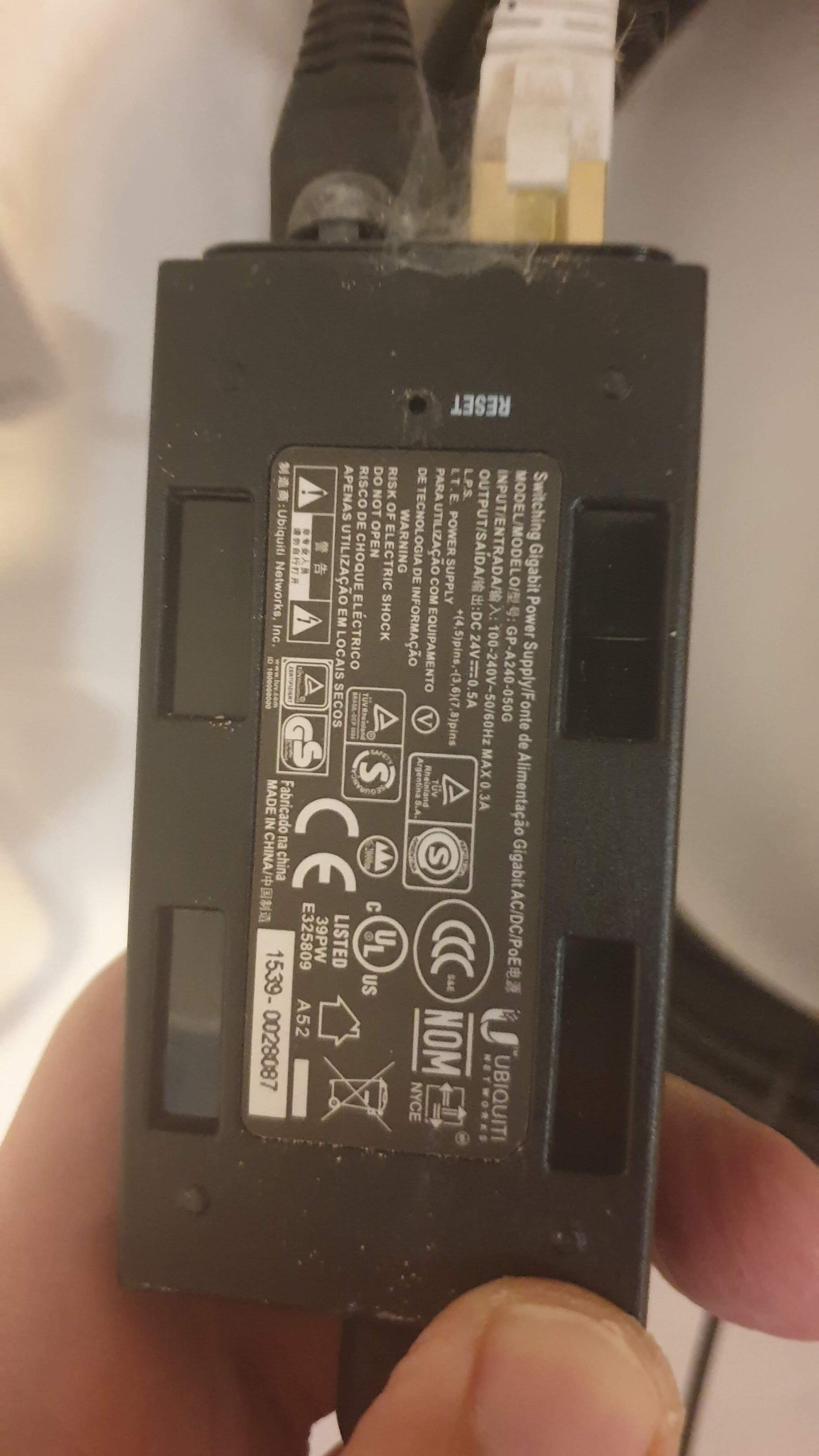

I am now about to order my Wireless Wire kit. I have one more question regarding PoE.
As already stated I am using Ubiquiti Nanobeam 5AC 16s … they come with PoE Injector with Gigabit interfaces as well.
Is it possible that I continue using those PoE injectors with the Wireless Wire devices to power them? Would mean less work in terms of installation for me …
Here are the tech specs of the 5AC 16s in terms of power supply.
Power supply specs are: 24V, 0,5A (24 Watts)
Thanks,
