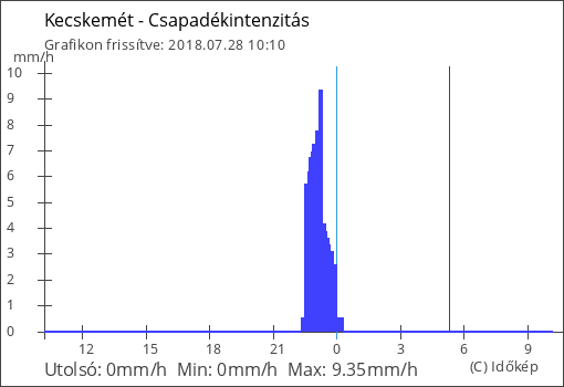

Yesterday we had small storm here, both 640m and 1400m link stopped several times sometimes for seconds, but even 2 minute outtage happened.
mcs: 8
phy-rate: 2.3Gbps
signal: 80
rssi: -58
tx-sector: 56
tx-sector-info: left 1.4 degrees, up 1.4 degrees
distance: 640.23m
jul/27 22:15:03 interface,info wlan60-station-1: link down
jul/27 22:15:27 interface,info wlan60-station-1: link up
jul/27 22:24:15 interface,info wlan60-station-1: link down
jul/27 22:24:50 interface,info wlan60-station-1: link up
jul/27 22:26:42 interface,info wlan60-station-1: link down
jul/27 22:26:50 interface,info wlan60-station-1: link up
jul/27 22:55:08 interface,info wlan60-station-1: link down
jul/27 22:55:11 interface,info wlan60-station-1: link up
jul/27 22:55:55 interface,info wlan60-station-1: link down
jul/27 22:56:07 interface,info wlan60-station-1: link up
jul/27 22:58:07 interface,info wlan60-station-1: link down
jul/27 22:58:42 interface,info wlan60-station-1: link up
longer:
mcs: 8
phy-rate: 2.3Gbps
signal: 80
rssi: -60
tx-sector: 36
tx-sector-info: center
distance: 1389.94m
jul/27 22:13:41 interface,info wlan60-1: link down
jul/27 22:13:50 interface,info wlan60-1: link up
jul/27 22:15:12 interface,info wlan60-1: link down
jul/27 22:19:27 interface,info wlan60-1: link up
jul/27 22:26:25 interface,info wlan60-1: link down
jul/27 22:26:28 interface,info wlan60-1: link up
jul/27 22:27:18 interface,info wlan60-1: link down
jul/27 22:28:52 interface,info wlan60-1: link up
jul/27 22:28:56 interface,info wlan60-1: link down
jul/27 22:28:59 interface,info wlan60-1: link up
jul/27 22:29:15 interface,info wlan60-1: link down
jul/27 22:29:18 interface,info wlan60-1: link up
jul/27 22:29:24 interface,info wlan60-1: link down
jul/27 22:29:26 interface,info wlan60-1: link up
jul/27 22:55:50 interface,info wlan60-1: link down
jul/27 23:01:58 interface,info wlan60-1: link up
jul/27 23:02:05 interface,info wlan60-1: link down
jul/27 23:02:08 interface,info wlan60-1: link up
