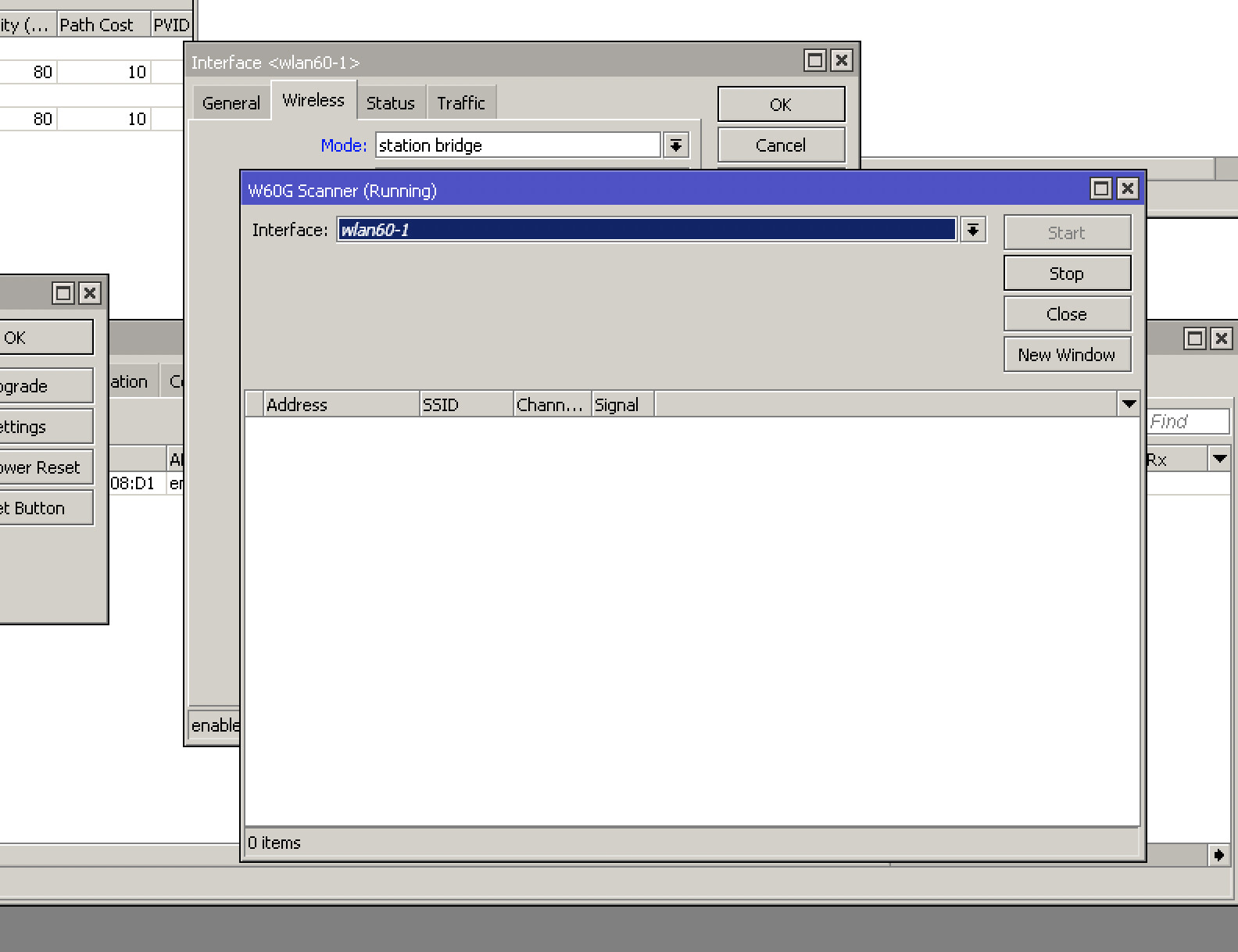

AP Bridge Frequency: 66960
No link at 1300m
Station Bridge Scan, finds nothing

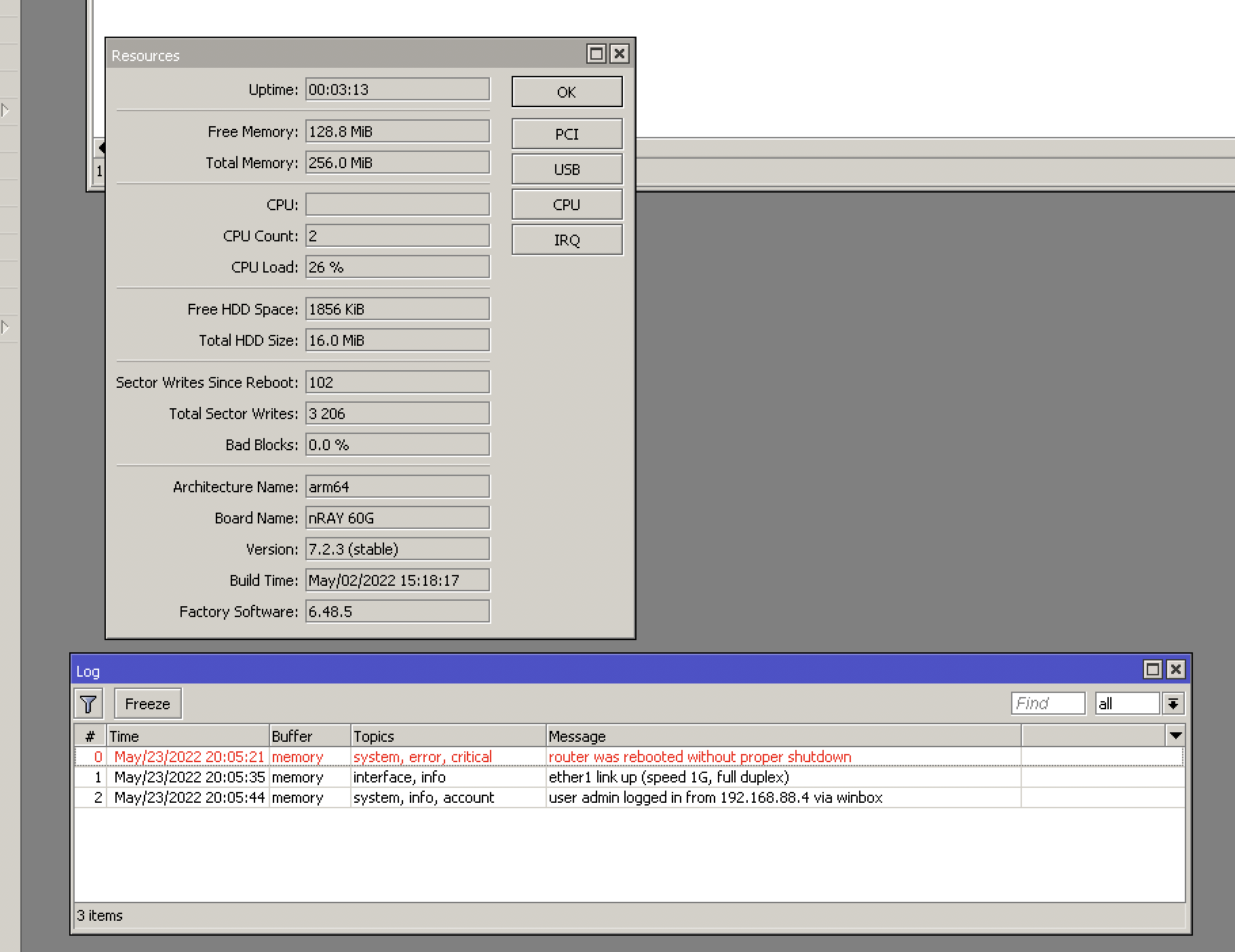

also I noticed this anomaly, without doing anything the antenna restarts automatically for a problem as you can see from the forwarding log the CPU is always between 24/26% after updating to 7.2.3
I will try to reinstall everything via netinstall and see if it solves the problem
