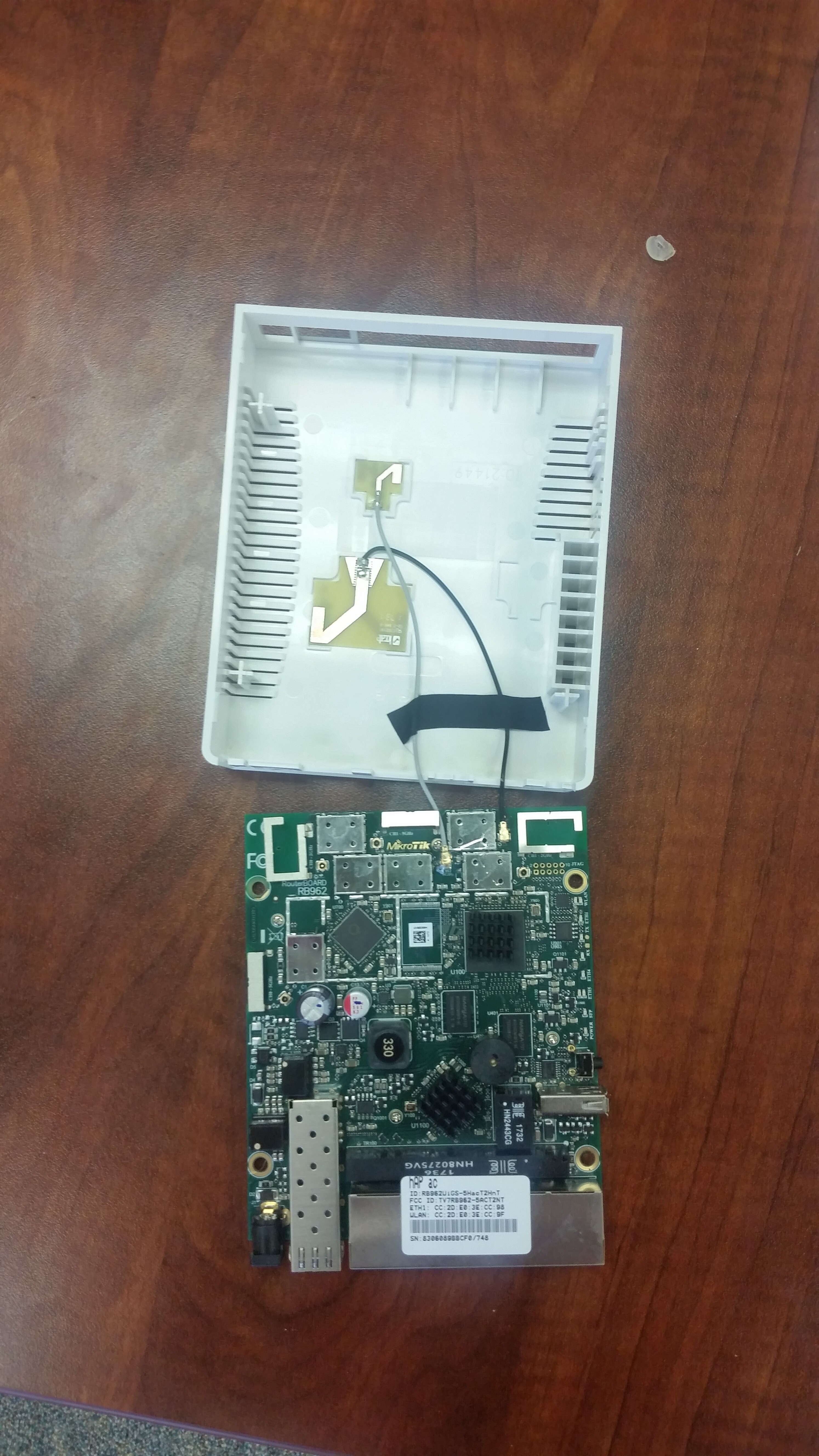

Digging deeper trying to determine why the gain had to be down rated so far to be stable, we opened the case.
As you can see there are 4 integrated antenna’s (near 0 Dbi) and 2 discrete antennas (guessing 7-9 Dbi) so the 2/3 figure given must have been an average, which is crap as you’ll have packet loss out the wazoo on the weak spacial stream; which is likely behind much of the odd intermittent problems we’ve been facing.
After testing we disabled chain 2 and set the gain on 0,1 to zero. Throughput is affected a bit in short range but more then made up for in the consistent performance over the whole range.
Shame on Mikrotik for these shenanigans.

I think 0 gain in fine once the crappy antenna’s (2) are disabled. We had used a higher gain in an earlier version, prior to discovering the two quite different antenna configs.
