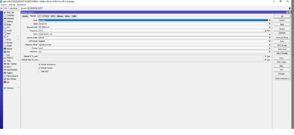

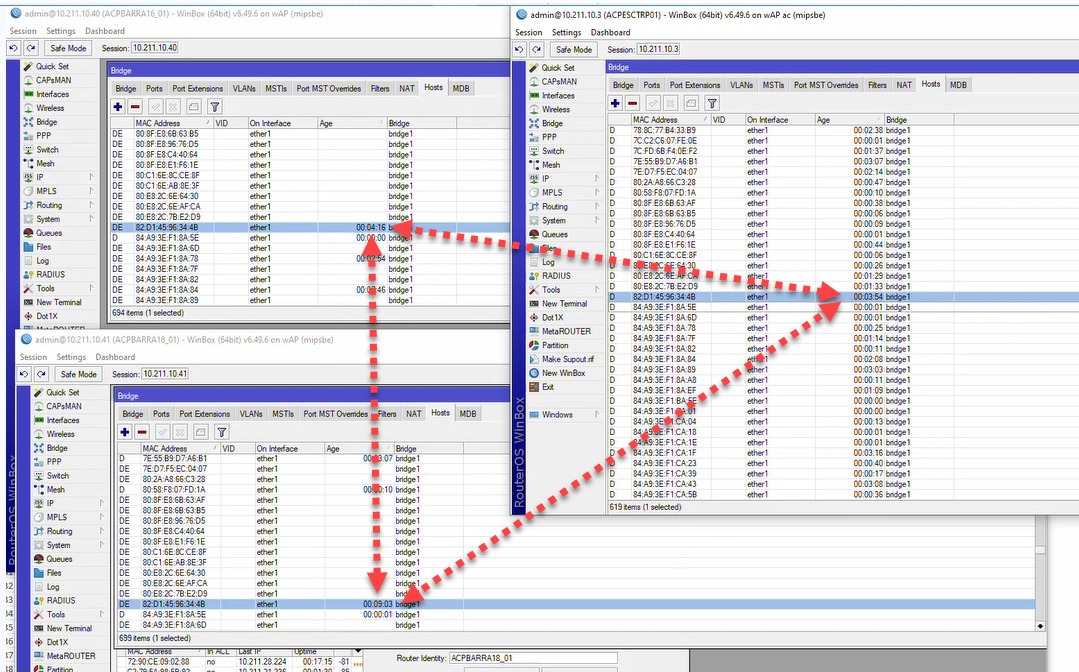

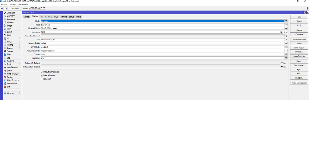

Aparece na configuração de Bridge (hosts), em várias antenas, mesmo em antenas que não me conectei.
Configuramos uma bridge para a interface eth1 e wlan. (print em anexo).

Forgot bridge “hosts” table in the list of possible places to find a MAC address.
What is the “hosts” table? It’s the MAC address list for the bridge. (You can see something similar in the Switch “Host” table with HW offloading)
Host/Hosts MAC table is used for the switch/bridge function to know where to find a specific MAC address in the network. To know on what interface to send the packet with that MAC destination.
Here it says ‘ether1’ on the IP= 10.4, 10.40 and 10.41 devices
So it can be found on the ethernet interconnection, and it is NOT on one of those 3 devices or on their WLAN interface. Somewhere in that L2 (bridged/switched) ethernet network.
