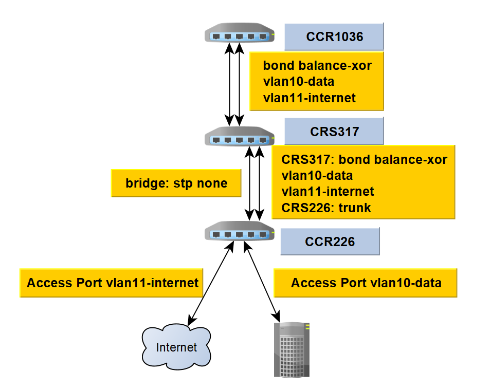

Configuration1:
  • 20gbps bond between CCR1036 & CRS317
  • 20gbps bond/trunk between CRS317 & CRS226
  • It works mostly, but sometimes some packets are dropped between the CRS317 & CRS226 (most visible on DNS/SNMP)

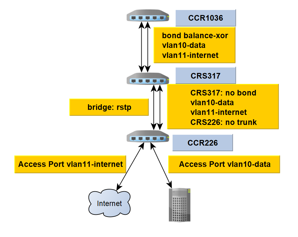

    Configuration2:
  • CRS317 forced as rootbridge
  • 10gbps failover link between CRS317 & CRS226 (thanks to RSTP)
  • This works, but no bond/trunk for aggregated 20gbps link
