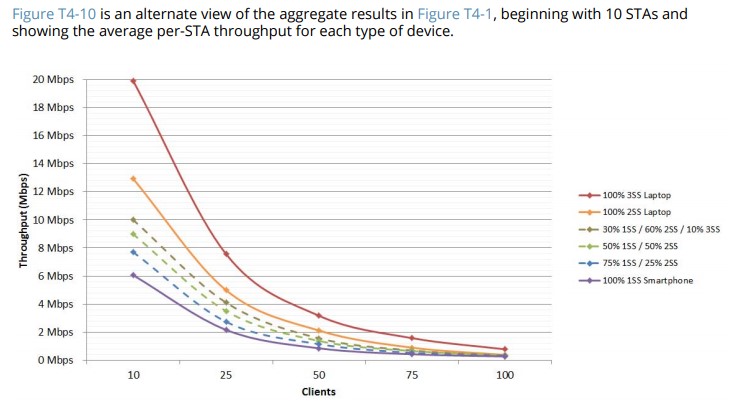

What is the max PHY rate of your connection? 20 MHz wide channel , 2x2 stream clients, higher than -60dBm signal … gives 144Mbps interface rate. This is 70 Mbps data rate at its best.
60 devices, is 1 Mbps/ device, if all are in that strong range.
But some clients are further away, may be single stream, what is their data rate? 36 Mbps , 6 Mbps ??? They’ll eat a larger part of the available air-time.
But there is also an overall capacity decrease when there are 60 clients (see Chapter T4 and other in https://howwirelessworks.com/wp-content/uploads/Aruba_VHD_VRD_Theory_Guide.pdf )
