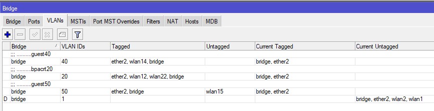

Please use this great tutorial on how to configure VLAN’s with MikroTik:
There is a first must read, if you want to understand the current way of handling VLAN in Routeros (aka “bridge method”.) See link above.
However to take a shortcut , I use 2 ways to handlel this in the AP.
  1. Also old style (when VLAN’s were handled via Switch, or just handled with a non-smart bridge (this is one where the VLAN’s are not configured))
For this method add all WLAN to the one bridge with also ether1, and fill in the VLAN id to tag in the Wireless setup of the WLAN where needed. Set VLAN mode to “use tag”.
All done, this works immediately, until you want to have 2 WLAN (eg one 2.4GHz and one 5 GHz) connected to the same VLAN. In that case this setup failed (the WLAN started to use the untagged connection). EDIT ! → the setup failed because there was an Access List rule setting the second WLAN to untagged ← EDIT !

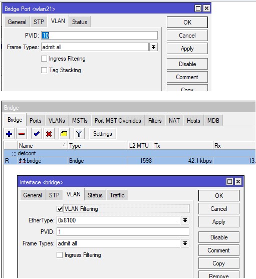

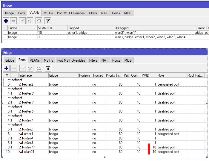

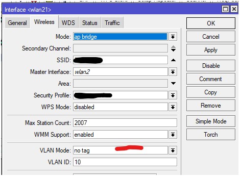

  1. Just happen to have set up and document the second method because of the above failure.
    This is just about one VLAN 10 , to be distributed by two WLAN , WLAN11 and WLAN21 (2.4 and 5 GHz). The original WLAN1 and WLAN2, and other ether ports use the untagged.
Not the finest and purest setup (Frame type, Ingress Filtering, and other settings not considered) , but at least this combination works. The VLAN traffic is delivered untagged to the WLAN.
Be aware that enabling “VLAN filtering” on the bridge can lock you out of the MT router! Always use “Safe mode” or have some ether port not connected to the bridge, as backdoor.
The VLAN ID =1 line in the bridge is created automatically by RouterOS, but that automatic line included WLAN11 and WLAN21 as untagged. So I added it myself.
