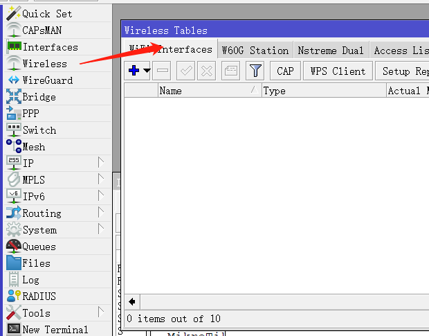

I just got the RB5009 device from my friend and restored the backup file from another router (different model), and it seems most settings has been set but wlan1 and wlan2 interfaces is missing in wireless.
[admin@MikroTik] > /interface wireless export
[admin@MikroTik] >
there is no any interfaces in the wireless window from winbox, I also did reset the configuration without keep user configuration and netinstall with install 7.1rc5 with totally no configuration keep, but does not help.
Is there any way I can get the wlan1 and wlan2 back? Or I just damaged the router and can not be restored?

Yes, I did factory reset via reset button, inside winbox, also netinstall. All failed, also checked the license is level 5 which should np for wireless.
It made me headache as I tried all the way I knew because I didn’t get the RB5009 backup before restore as I thought the factory should reset all the configurations.

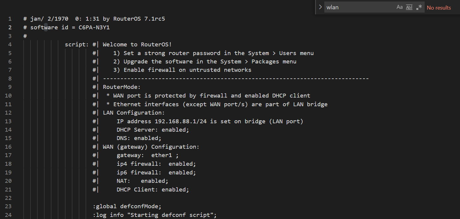

terminal
/system default-configuration print file=defaultsettings
Check file defaultsettings.rsc
Does that show config for wlan interfaces ?
If yes, extract that part for wireless reconfiguration.

ah, I saw the configuration content, I think the interface should exist before applying these configurations as ether1 and ether2 are already there.
it is something like a hardware-level issue in my opinion, but I don’t know why this happens.
