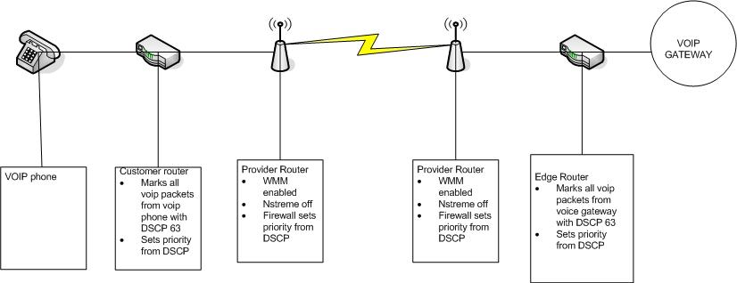

I have setup a basic LAB environment to test WMM capabilities but I found no improvement :frowning:
Maybee I am confused with what it actually does so please correct me if I have not implemented it correctly. Please see attachment:
The Providers edge are 2x RB433’s connected wirlessly and all the other connections are ethernet.
This is how I tested it:
  1. Configured WMM as per attachment and the priority is correctly assigned to the packets. I checked this by having this rule to the PE routers and the counters went up when I made a call:

It this the correct implementation of WMM or does it only help when there is enough throughput?

So what do you expect to happen? You’re flooding the line with traffic doing a bandwidth test, obviously the call quality will drop… It will drop even on Ethernet…
Ok let me re phrase the question…When/how is WMM supposed to be used?
I understand that it divides the station’s traffic into “4” access categories but how does that help if the link is saturated?
