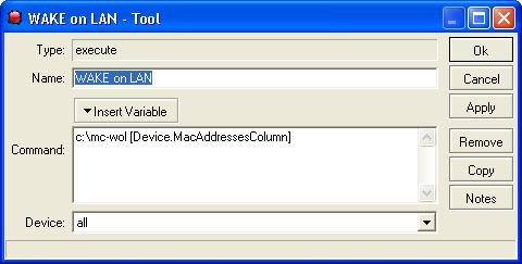

I read through this thread about using a WOL application. I was successfully able to do this without a batch file using the mc-wol app. I just put the app on C: and used this command:
c:\mc-wol [Device.MacAddressesColumn]
It works great. The problem is, I have to create that for every single device manually. I was wondering if any good programmers out there know of a way to have this created automatically for every device that gets discovered on the network. Try to create this manually for almost 300 devices would be quite tedious. Thanks!

From reading a couple of your posts maybe this will help…
Create a New tool, put your command in the tool and assign it to all devices or pick a specific device type…
Then you can right click on a device and select that tool.

Very helpful, that was it exactly. Thanks!
