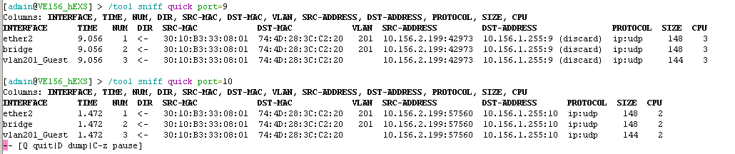

Waking up the PC inside the same network works properly even though quick sniff shows that the packets are “discarded”, WoL also works through the routers WoL tool when the correct interface is selected.
