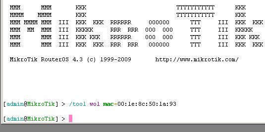

the command is
/tool wol mac=00:01:02:03:04:05
Works for me. v4.2

Starts perfectly on WOL using
But still no luck sending tha package using winbox and the tool in RouterOS.
what if you add the interface command e.g.
/tool wol mac=00:01:02:03:04:05 interface=ether1
replacing ether1 with the exact spelling of the correct interface name. For a list of valid interface names you can press ? after interface=
:slight_smile: :slight_smile: Got it. That worked :slight_smile:
