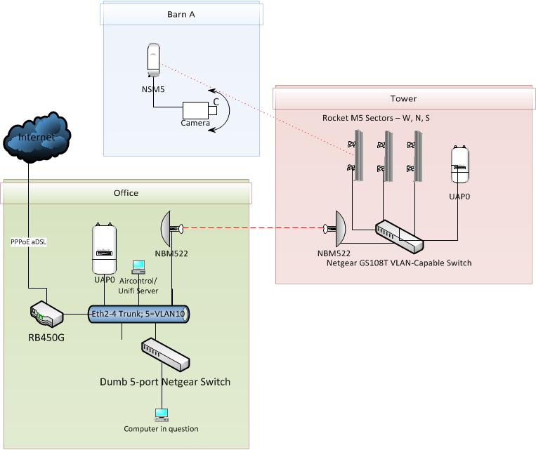

Hey Gentlemen,
I need some help here… I have a RB450G in place that has a couple VLAN’s set up; Eth1 is gateway, Eth2-4 are essentially trunk ports to VLAN aware equipment, and Eth5 is bridged to my VLAN10 Trusted VLAN… this plugs into a dumb Netgear 5-port switch, and into a couple computers.
What I’m seeing - traffic goes to the internet just fine… and if I’m somewhere else on the network down the line (on the same vlan, elsewhere so the traffic never has to make it to the RB) traffic flows fine - but as soon as I need to go through the RB - either to traverse VLAN’s, or from a computer on that dumb switch on Eth5, traffic doesn’t pass. I can ping it and I see fragments come through, but that’s it. Also, VPN’d into the router, I can get to everything just fine… it’s just sitting on the network that it goes to hell.
Further testing via ping shows that packets up to 1468 bytes pass just fine - as soon as I go to 1469 or above, I get request timed out.
I’ve read a lot of stuff here and there about MTU settings and all that, and I’ve tried a couple tests, but I’m a little out of my league here, and could really use a hand. Below is my config - if you see anything relevant, please let me know! Thanks in advance!

Gentlemen - I really am at a loss here, and would appreciate any help or even troubleshooting suggestions.
Here’s some additional info I’ve come up with, including a diagram of the whole setup:
In the attached image, you can get a basic gist of the network I’m dealing with here. I have a management VLAN (untagged) and a normal-use VLAN (VLAN10). Coming off the routerboard, I allow all VLAN’s except on Eth5, which is bridged with the trusted VLAN… so when it gets to my UAP-Outdoor wireless devices, you get a certain VLAN depending on the SSID you joined. All that seems to be working as expected.
Here’s the problem I’m having - The camera connected to the Nanostation - If I’m on the wifi at the tower on the same VLAN as it, I can access it. If I’m on the wifi at the office, on the same VLAN (UniFi so they’re all the same) I cannot. If I’m anywhere on a different VLAN, I cannot access the camera. If I’m VPN’d in, I can.
I was originally chalking this up to a routing issue, but I’m able to transverse from one vlan to the next just fine - except, if I pass back through the router for any reason, my packets drop.
Here’s what I finally found - I can ping the camera, but when I specify certain size packets, they start dropping over 1468. I didn’t specify don’t fragment. If I ping the AP that the camera is connected to, it doesn’t matter the size of the payload - I always get a response… unless I select DF. The camera is connected to the NSM5 directly; on the NSM5, WLAN.10 is bridged to LAN in order to put the camera on VLAN10. Interestingly enough, if I ping the NSM5 that the camera is plugged into, I can send larger packets and they just fragment as needed to pass; it’s when I hit the camera that I have the problem.
So - I’ve got to believe this is related to MTU, unless I’m totally missing something.
When I ping different devices and specify packet size, anything over 1500 bytes doesn’t make it (unless I ping the switch at the tower - it’ll take almost anything I send to it)… I’m not choosing don’t fragment, but the packets won’t fragment anyways - I don’t understand.
At this point, all ubnt gear has MTU set to 1600; the routerboard I’ve experimented with dropping it down to 1400, and upping to the max - but no matter what I do, I get the same results… am I not understanding something correctly here?

I’m guessing you are running your ping tests from Windows. For some reason, Windows ping does not take into account either the IP header or the ICMP header in the ping size you specify, and those two headers add up to 28 bytes. This means that in Windows, the largest size you can specify for a non-fragmented ping packet on an interface with a 1500 MTU is 1472 bytes. So, in essence, when you specify a 1472-byte ping in Windows, it’s really sending 1500 total bytes.
I note that 1468 is 4 less than 1472. Or, to put it another way, 1468 + 28 is 4 less than 1472 + 28. Or rather, 1496 is 4 less than 1500.
4 bytes is the perfect number for a 1Q VLAN header to be hiding in.
I think you mentioned that all of your devices are VLAN-clean/aware. But I’d look at everything again, with a more discerning eye. You’re probably missing something somewhere that doesn’t like those VLAN headers, and it is effectively reducing your MTU by 4 less than whatever you’re setting it to.
“Devil” is right: you can surely work around the issue by mangling TCP MSS. But this will merely mask the true problem, not solve it. Something somewhere in the path is stealing 4 bytes of every frame, and the fact that you’re using 1Q VLANs and that they happen to add 4 bytes to a frame is a big clue…

I really appreciate the replies - if you do get a chance to look a little closer and have any more ideas, I’d be eternally grateful.
I was initially doing the ping through windows, but I also have a debian box there sitting directly on the untagged management VLAN and I’ve done some testing with that one too - and that one is polite enough to reply back with what the actual packet size will be after the overhead is added.
The part that I don’t understand, is I’ve set the MTU to 1600 on every device along the way, but that didn’t help - shouldn’t that make up for the 4 bytes from the VLAN being added? And Why can I reach every other device on this network except this camera - and I can reach the camera if I’m on the wireless at the tower location - just not if my trafic has to pass through the mikrotik in any way? That’s what really has me stumped.

I could be totally mistaken, but I have my doubts that the UBNT gear’s ethernet interfaces can do more than 1500 MTU (not counting ethernet frame headers). It’s wireless chip may be able to do 1600, but the unit as a whole probably can’t do 1600 end-to-end. I’d have to read up on it more.
Can you humor me by re-implementing your 3-port trunk port group as a software bridge instead of via the built-in switch chip? So, something along these lines:
/interface ethernet print
/interface ethernet set 1-3 master-port=none
/interface bridge add name=trunk-bridge
/interface bridge port add bridge=trunk-bridge interface=ether2-master-local
/interface bridge port add bridge=trunk-bridge interface=ether3-slave-local
/interface bridge port add bridge=trunk-bridge interface=ether4-slave-local
/interface vlan set [find] interface=trunk-bridge
(You’ll also, of course, need to make sure that you change any other references to ‘ether2-master-local’ anywhere else in the system to ‘trunk-bridge’.)
Then try again. If this works, it would suggest that MikroTik implements the switch chip master port interface using a VLAN between the CPU’s built-in ethernet interface and the port on the switch chip it’s attached to. In that case, creating VLANs on switch chip ports actually results (unbeknownst to you, the user) in you creating Q-in-Q tags within the MikroTik itself, even though that is not how it is represented in the RouterOS UI/config. Since this would be happening behind-the-curtains, so to speak, it might be contributing to your problem.
Also, looking at the one bridge interface you already have, I’m slightly confused/concerned by the fact that it shows an MTU that is higher than the interface’s L2MTU.
Thinking about this again after having typed all of this out, I wonder if perhaps, again, based on how MikroTik may have implemented the master switch port feature internally, it is best not to mix VLANs defined on the switch chip with software bridges? The other thing you could/should try would be to make ether5 a slave to ether2 and the use ‘/interface ethernet switch’ to untag VLAN 10 on ether5 instead of using a software bridge to do it.
My guess is that either implementing your VLAN trunk and access ports entirely in software bridges OR entirely in hardware switching will fix your problem. I’m thinking it’s the mixing-and-matching of both hardware and software switching that you’re doing that is possibly causing or somehow contributing to the problem.
– Nathan
Thanks for the tips. The equipment is located 2.5 hours away from me - I was working remotely and knocked myself out of the radio and camera in question :unamused: but I’m driving up there in the morning so I’ll be able to try more on-site.
One thing I did notice - when I put the camera on the management vlan (removed the bridge that tied the radio’s wlan.10 vlan to the ethernet port; gave the camera an IP on the management vlan) that the problem seemed to go away - but that leaves it on the wrong subnet.

Hi Nathan - I need to say, I greatly appreciate your help - taking the time and the personal interest in my problem, and I do actually feel pretty guilty taking so long to get back to you.
I struggled with this quite a bit, and got to where the reward of the separate VLAN’s wasn’t worth the amount of time I had into it. This is a billable project, yet my 20+ hours on this issue is not billable, and was only delaying final payment. That said, I decided to flatten the network slightly and put the computers and cameras on the same VLAN. Talk about a deflated feeling of defeat!
That said, I have duplicates of all of the production gear - router, wireless units, cameras, etc - and hope to reproduce this in my lab as soon as I get a chance - because I’ve never let a computer get the best of me!! When I get there I may shoot you a PM - and an offer to look around yourself if you feel like it… that’s the beauty of the lab!
Thank you again - I truly do appreciate the personal interest you took on for my sake here.
