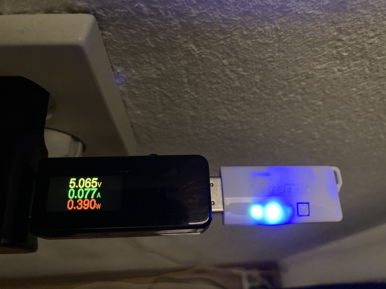

Hey, were you able to solve this issue? I have 5 woobm and all show that behaviour, even when i plug them into a linux box or even an usb charger (so for me it is not ros related). Could you please test if AP stays available (sends beacons/led flashes) if you connect a woob to an usb charger/power supply?
my woobm attached to a poweradapter. showing up as an AP, looks fine.
And NO, the issue is NOT solved, the bug is NOT fixed. ROS 7.5+ has problems with USB as confirmed by techsupport.
