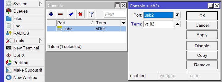

Pffff … couldn’t get in with Woobm.
Didn’t know you have to define a USB console first on the hAP ac2 ROS 6.47.10.
No idea if this is new with some version of ROS or not. But by creating the console, now I can get in a hAP ac2.
Probably similar with other MT devices.

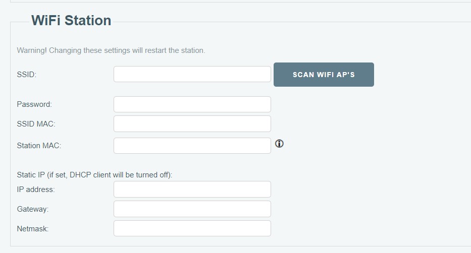

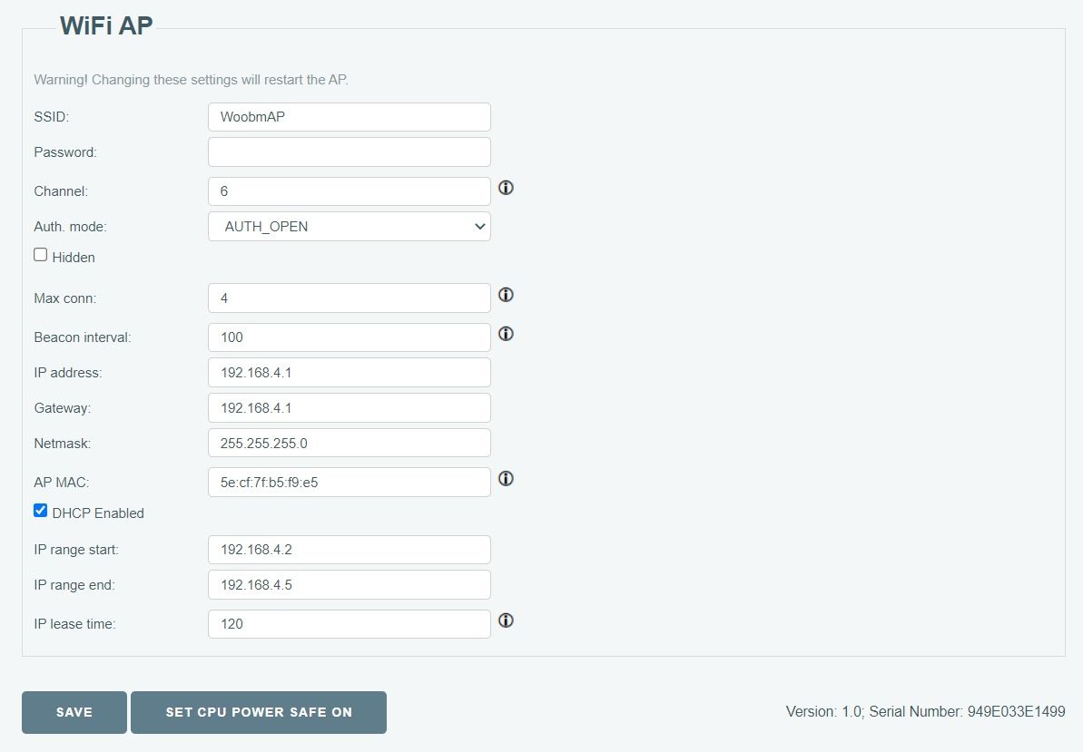

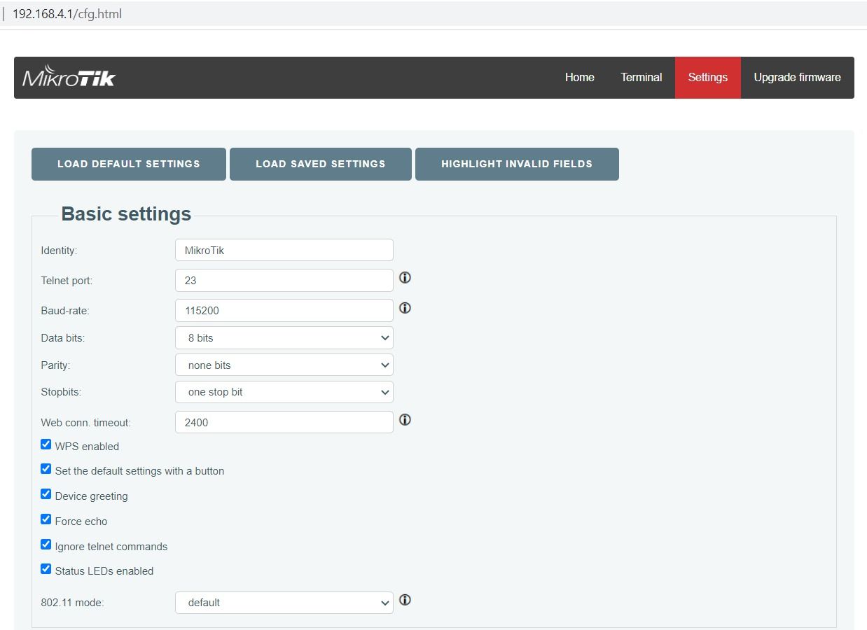

FYI … the Woobm screenshots
