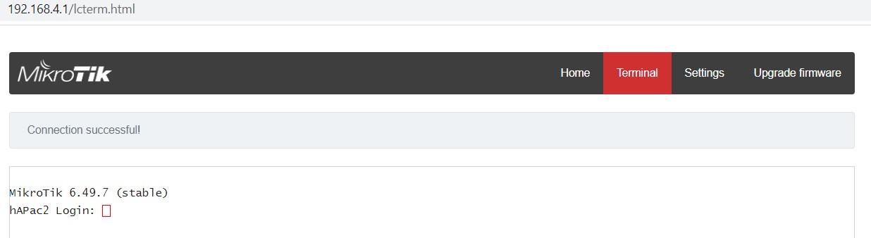

Is anyone still using these? I’ve got one that I pull out now and then when I’m having trouble getting connected to a router, except for the last several years it has not once successfully launched the terminal window on any computer I’ve tried to connect to it such that I can actually send commands to the remote device (I can see the console output, just not interact with it, so it’s still somewhat useful at times). It seems to have been related to some update on the computer / browser, but I can’t even pinpoint which year the problem first occurred.

WOOBmAP works fine here.
Some client devices are not happy if a wifi connection does not give access to internet, a browser may stall on this.
This connection does indeed not have internet access.
