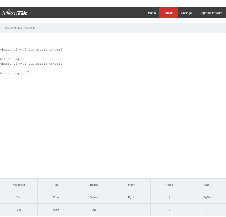

i tought, the stick is working like RB411 with the SSH to Serial option (plus the WEB interface) - so i planned to use it with Linux machine.
The machine recognise the stick az ttyUSB0 so i tried getty, and after nothing happened, i tried minicom to check whats going on.
Web console does not worked, telnet neither.
So i think, woobm waits for Mikrotik’s serial prompting on serial (USB) line and only thinks, its connected, if proper prompt received.
Is this true?
woobm is basically a prolific PL2303 usb to TTL serial adaptor glued to an ESP8266 + some local flash.
as far as i know, ssh is not supported at all - which is kind of disappointing.
let me check it what does it do when i plug it into an usb charger :slight_smile:
well, no. i just plugged it into my MBA, started screen with 115200 baud rate on the newly discovered USB tty, and was able to connect via TCP/23 and to the webpage as well. safari does not like the “web terminal” very much, but the communication works: whatever i put into the terminal is displayed on the web page and vice versa. so whatever keeps you to get a login prompt on woobm, it is not because the stick is blocking anything.
For example on Ubuntu 14.04:
Device /dev/ttyUSB0 should be exist after plug in Woobm-USB into USB-port:
ls /dev/ttyU*
/dev/ttyUSB0
Now we can create the configuration file for initialize a console on the device /etc/init/ttyUSB0.conf:
touch /etc/init/ttyUSB0.conf
This file should contain this code:
# ttyUSB0 - getty
# This service maintains a getty on ttyS0 from the point the system is
# started until it is shut down again.
start on stopped rc RUNLEVEL=[12345]
stop on runlevel [!12345]
respawn
exec /sbin/agetty -L 115200 ttyUSB0 linux
Now You can start console on device /dev/ttyUSB0 just using the command
sudo start ttyUSB0
Result:
I tried to use different terminals: vt100, vt102, linux, xterm. In the telnet session with xterm, even mc (midnight commander) will work. In the WEB-interface, any attempts to run mc will end with error “Disconnected (code 1006). Please try again”.
