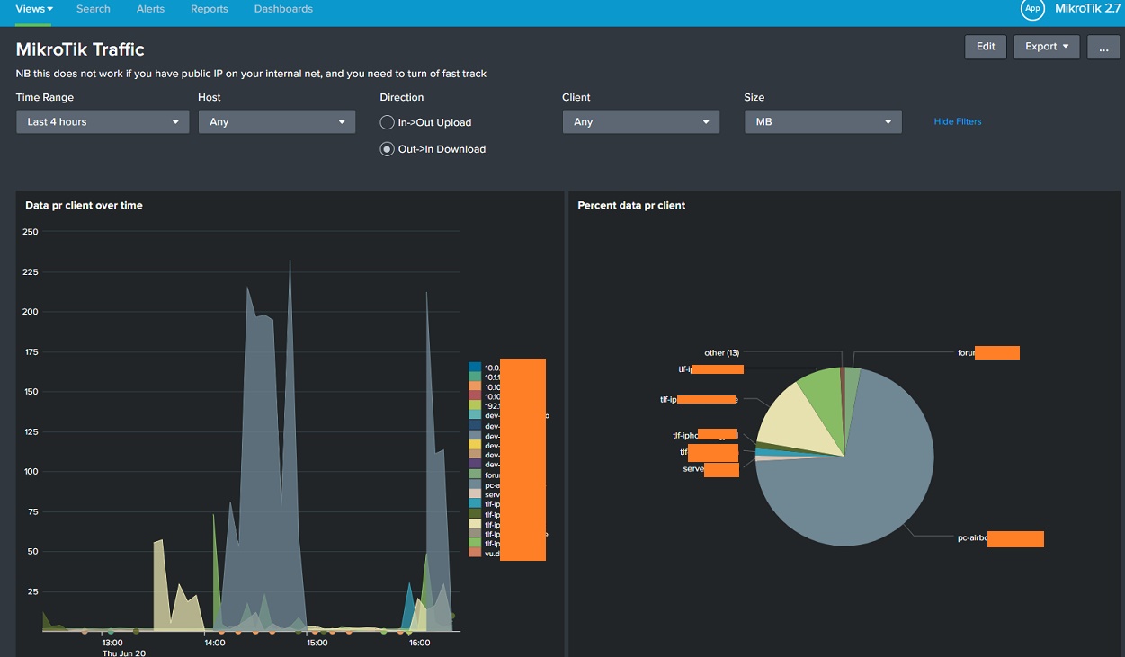

Look at Splunk in my signature.
Here are what I do.
All DHCP->Static
Add DNS Name to host that I do now what is.
Then using account snapshot to get the traffic to Splunk.
In Splunk I have Dashboard that show me who are using how much. I can select one user and see that user over time.
See example one example here. This are just som part of the information I do get. DNS/Filter/Traffic/UPtime/DHCP/Resources ++++++
