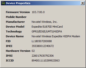

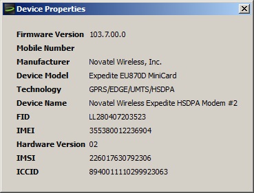

Modem is recognized by ROS at first start-up after mechanical installation. Default ppp-client interface is created automatically. Tested 2 pieces, both of them unlocked. Firmware version in both cases is: 103.7.00.0 HW Version: 02.
Configuration used by me is basically the default one:
Data channel=0
Info channel=0
Since Vodafone Romania does not require user&pass i inserted only the APN and enabled the interface. Monitoring was performed over 7 days. Link remained stable. It is true that the speed with this modem is not fantastic but as a backup/failover option will do the job. I’m attaching screens with the HW Details for the two modems taken from the Windows application. To connect the modem to Windows machines you need a simple adapter with either USB port or mini pcie SIM Adapter.

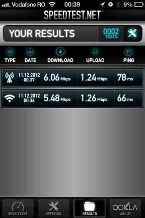

L.E Speedtest performed from my phone using direct internet connection and wifi connection over RB411U with EM820w. Same GSM Network Operator (Vodafone), same location and same test server. 5.48Mbps over EM820w and 6.06Mbps directly from the phone. 7.2Mbps network coverage in the area.
