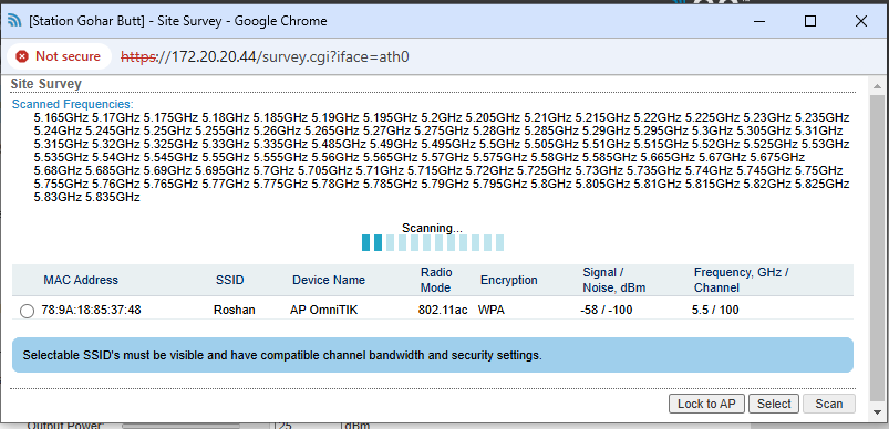

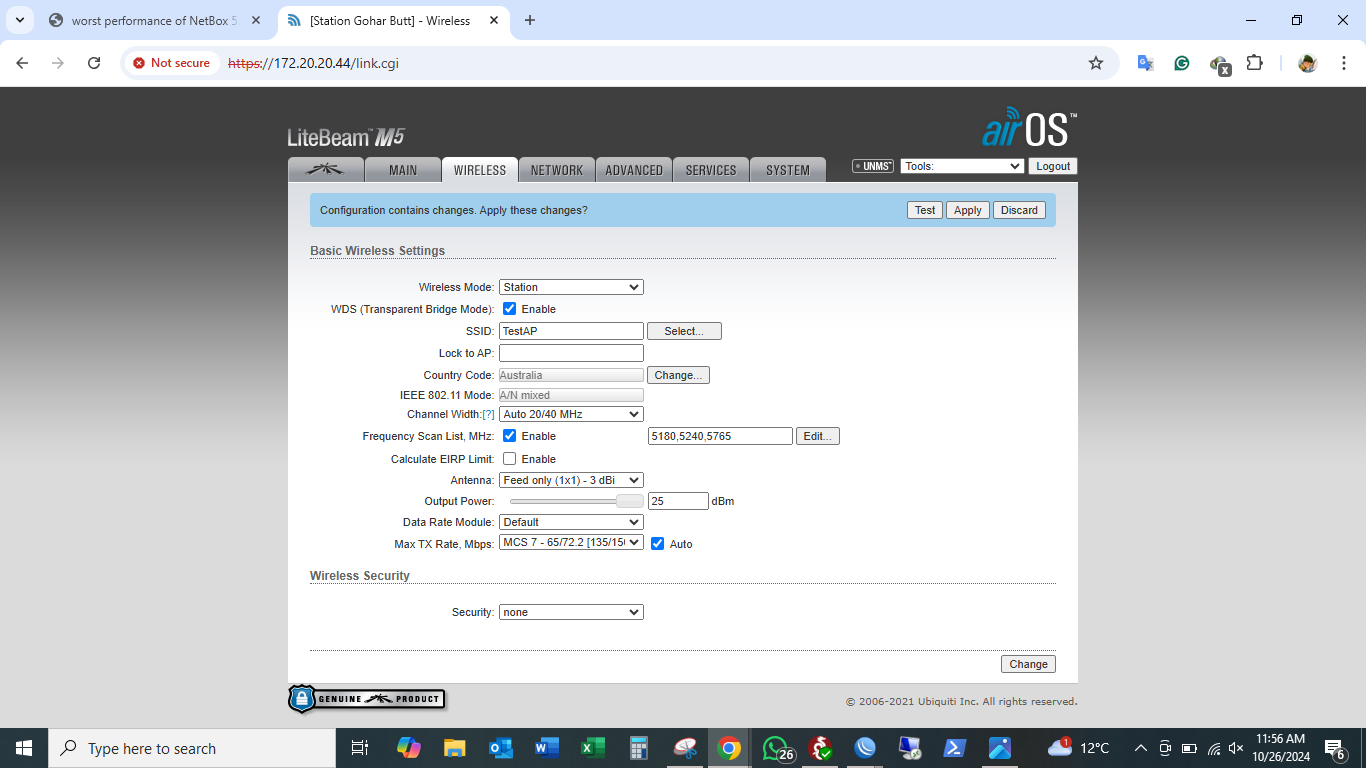

Band 5Ghz AX remain same for Sxtlite 5 and Litebeam M5 ?
Or I need to b change it to AN etc
not shown in scan…!!

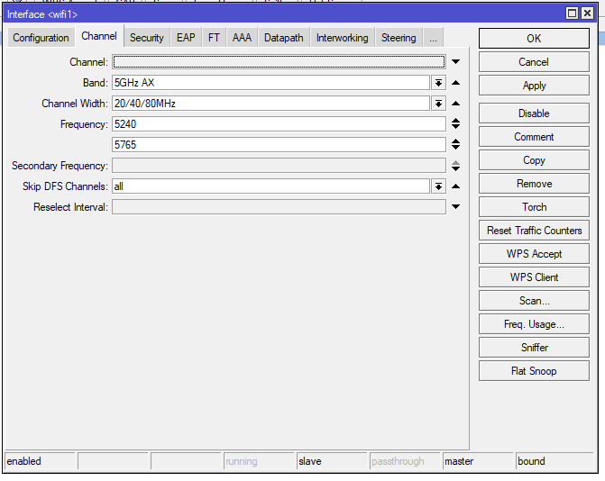

add name=Bridge1
/interface wifi
set [ find default-name=wifi1 ] channel.band=5ghz-ax .frequency=5240,5765
.skip-dfs-channels=all .width=20/40/80mhz configuration.country=Australia
.mode=ap .ssid=TestAP disabled=no
add bridge=Bridge1 interface=wifi1
add bridge=Bridge1 interface=ether1

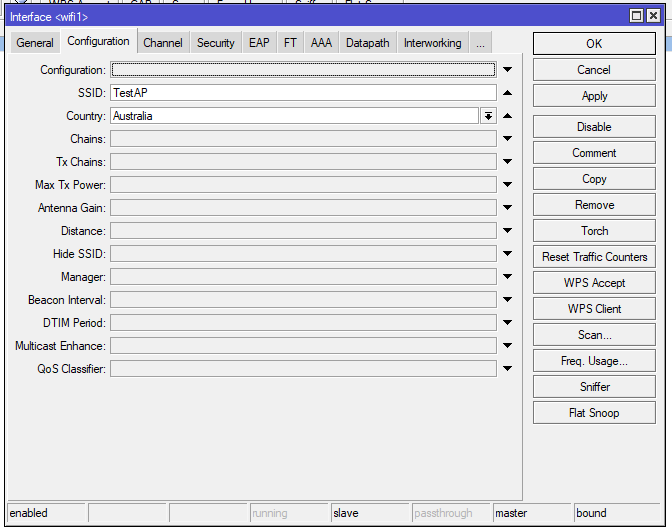

Can you set country code in correspondence with the country you are in (the NTP setting indicates something else)?

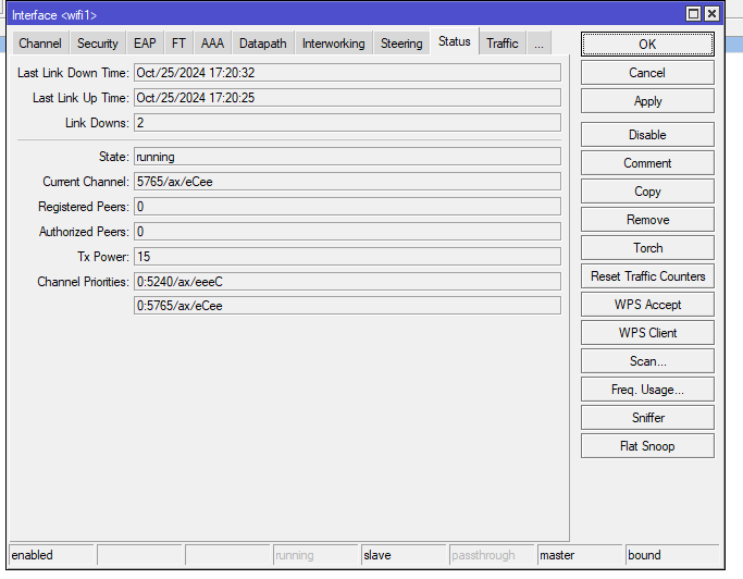

What is the status of the radio of the Netbox?
/interface/wifi/radio/print detail
/interface wifi print
