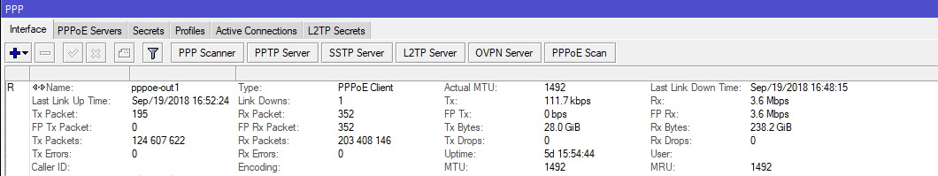

Wrong "Last Link Down Time" in Winbox
did not know exactly when this happens. But in WinBox, the “Last Link Down Time” is displayed wrong. It is correct displayed in the Web-Interface.
It display some time in the future, it looks like starttime of WinBox + 30 hours. Uptime itself is correct.
See screenshot.
