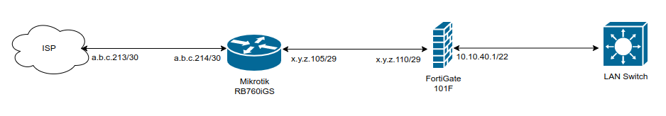

I need to make the outgoing IP to the internet x.y.z.110 and not a.b.c.214. My ISP gave me a /30 for the WAN side and a /29 for the LAN side of my router.
While the internet connection is working fine, when I check the outgoing IP I realize that it is not what it should be. I think I have a NAT misconfiguration somewhere but I don’t know where.
Attached is a diagram and the configuration of my router.

Instead of action=masquerade (which selects address automatically), use action=src-nat to-addresses=x.y.z.110.
Don’t use the NAT ? Why use NAT if your Fortigate101F can do that for you ? That Fortigate can make all internal 10.x.x.x traffic coming out as x.y.z.110
All the rest is just routing.
Or that ^^^, even better. But if you need NAT for 10.250.250.0/24 subnet, then exclude public subnet from srcnat using src-address=!x.y.z.104/29.
I did not even look at the config-file but only the picture. :smiley:
Then he better had some extra segment 10.250.250.0/24 & 192.168.88.0/24 on the picture.
Yeah, in that case IF that 10.250.250.x and/or 192.168.88.0/24 needs Internet access then NAT is mandatory on the Mikrotik again.
Thank you very much for the answers. Sorry, I forgot to mention, I don’t need internet access from the networks 10.250.250.0/24 nor from 192.168.88.0/24. Only from 10.10.40.0/22.
So, if I understood correctly, I just remove the NAT from my Mikrotik router and with that I would have it solved, right?
Thanks again.
Best regards
Gabriel
Yep, that should do it. Give it a try.
And if you want x.y.z.110 to handle own firewalling for incoming connections, you should remove the last filter rule in forward chain.
I change NAT from masquerade to accept and disable last firewall policy and everithing is working that I whish.
