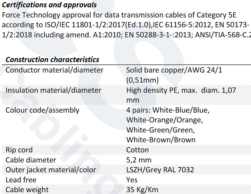

I would suspect the cables, are they copper or CCA? What exact cable is used?
I would agree on that too…
Check the cable termination too…

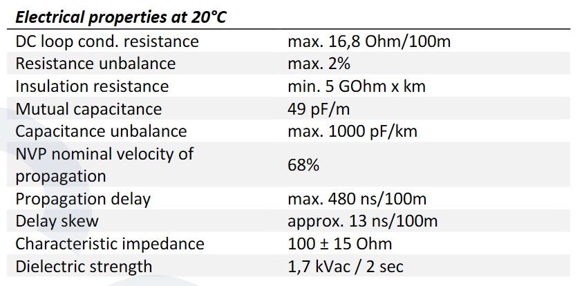

The cable should have these specifications.
