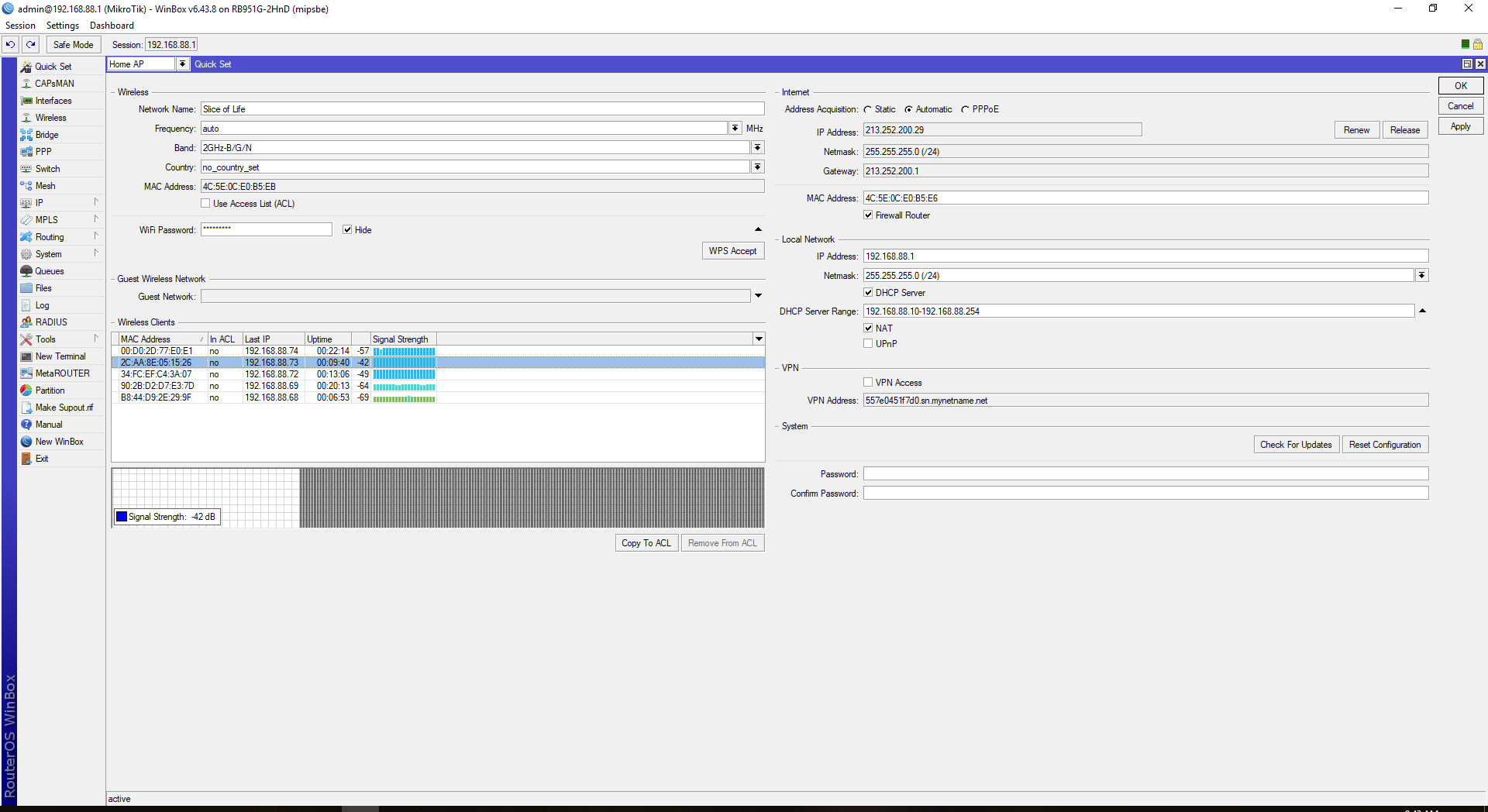

After all situation is still the same. Device connects to router (attached screenshot, it’s selected on wireless clients list), but didn’t get access to internet (blinking blue led on divece indicates that there is no internet connection).
As I mentioned before, the only (as I know) way to work around this problem is to disable default NAT rule (action: masquerade) for approximetly 10s. Device connects as soon as I enalbe this rule.
