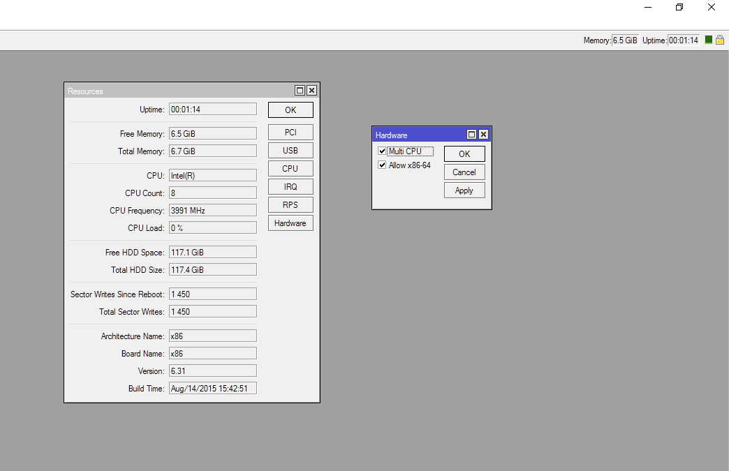

go to System → Resource → Hardware - check ‘Allow x86-64’ (in WinBox. can’t find it in CLI). reboot

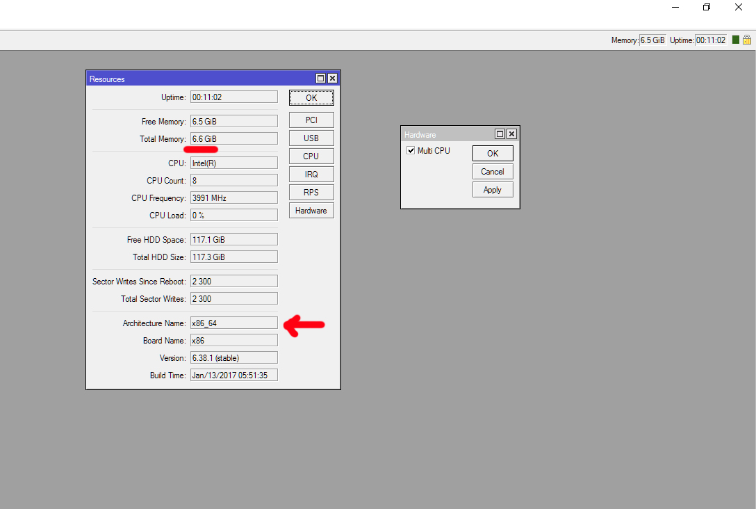

and voila!.. oops, ‘architecture-name: x86’ :slight_smile: no worry, just upgrade to the latest version:
[admin@MikroTik] > /sys resource print
                   uptime: 1m24s
                  version: 6.38.3 (stable)
               build-time: Feb/07/2017 09:52:42
              free-memory: 200.2MiB
             total-memory: 221.8MiB
                      cpu: Intel(R)
                cpu-count: 2
            cpu-frequency: 2933MHz
                 cpu-load: 0%
           free-hdd-space: 66.5MiB
          total-hdd-space: 99.2MiB
  write-sect-since-reboot: 708
         write-sect-total: 708
        architecture-name: x86_64
               board-name: x86
                 platform: MikroTik

Chupaka !!! Check this!
What I do… I downgraded our test router to 6.31 and enabled x64:
Then upgrade to 6.38.1:
It seems that krzysztof told us the true!!!
Just like I said :slight_smile:
Now you may press ‘Thumb up’ on my post and get back to studying 64-bit version :slight_smile:
