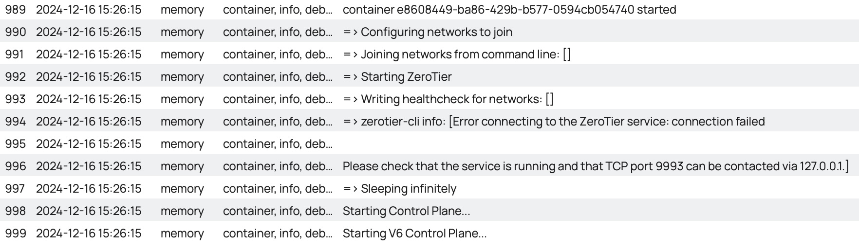

I have this running, same x86 CHR and definitely see info in logs - here is a copy of my log results and container (if it helps). I have the service disabled - that’s why it says error connecting. Should also still say running (and not stop immediately). Maybe reinstall?
