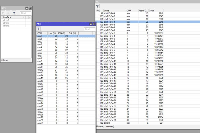

Processor loads are automatically created by threads created by the Intel X520-DA1 multi-threaded card (it can handle up to 128 threads per port). As you see in the picture, she created 32 threads by the number of processors.
As you can see from the picture, I disabled RPS and manually distributed the processors, so that there would be no overlapping threads on the same processor.
And if Mikrotik would use all the processors, then regardless of the firewall configuration, say, nat or shaper, we will see usage counters on other processors, but they are practically absent.
After the series of experiments, I found a problem.
In the previous picture, this is a production server with system.npk and routing.npk packages. The server makes Firewall Filer / Nat / Mangle, Simple queues and BGP.

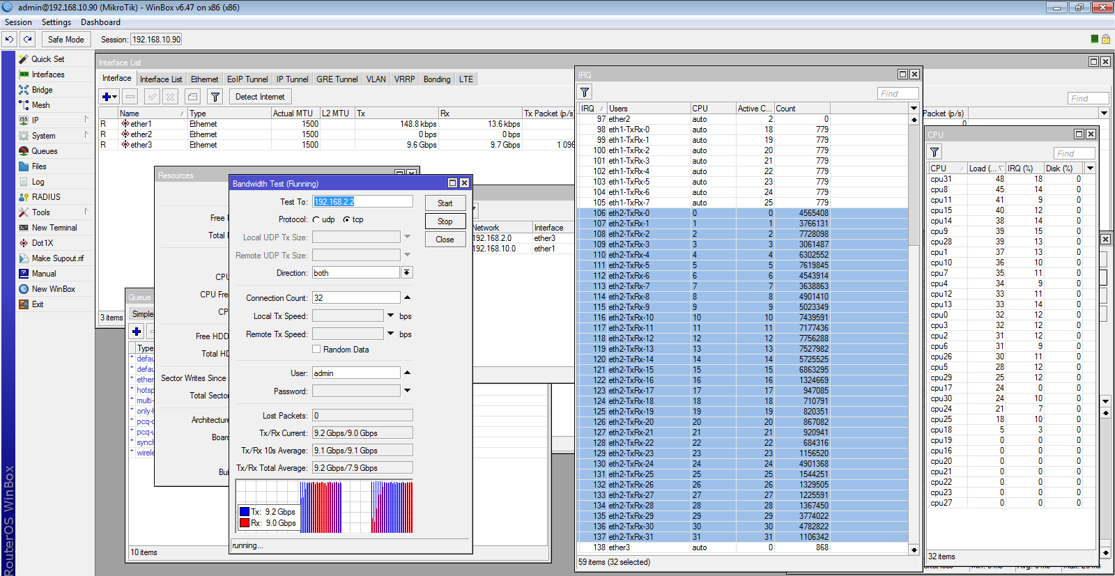

And in this picture it’s just bentdwith test.
It turns out that bandwith test can use all processors.
