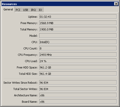

Not for our routers, all of them show different percentages:
Try to do something that will definitely eat up memory, like enable webproxy with “cache on disk” unckecked (cache in memory)
