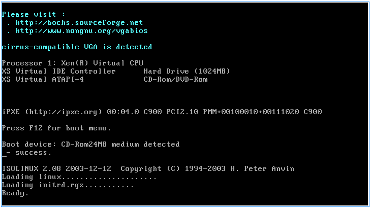

I’m attempting to install the x86 version of RouterOS 6.38 as a VM on XenServer 7.0. I’ve tried it on a couple different XenServer instances, and they all fail with a screen like this:
Is there a specific method to get this to function? I currently have an x86 instance [free] running on a laptop that I periodically use for btest. I’d to install the same version on a VM so I can get rid of the laptop.

I haven’t tried v7, but on v6 I had a problem that I’ve kept in my notes:
XenServer 6.2 (and perhaps earlier) added “Viridian” to support Windows 8. RouterOS won’t boot if this is enabled. Run xe vm-list to find UUID.
xe vm-param-set uuid= platform:viridian=false

This is the answer!
I setup the VM, but told it not to boot. Then, ran the above commands to turn off viridian, and manually booted the VM. It worked just as expected.
