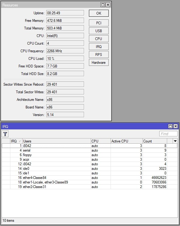

I have an x86 machine (on VMWare 4) that sometime crashes. I’ve already tested different router os version (5.19 too) but with no success.
I have another x86 machine working fine with 4.17.
Any idea? The only weird thing is this IRQ sharing resources (see image) for 2 ether interfaces… Is it normal?
Thanks!

I can assure that is NOT a problem from the IRQ sharing…
