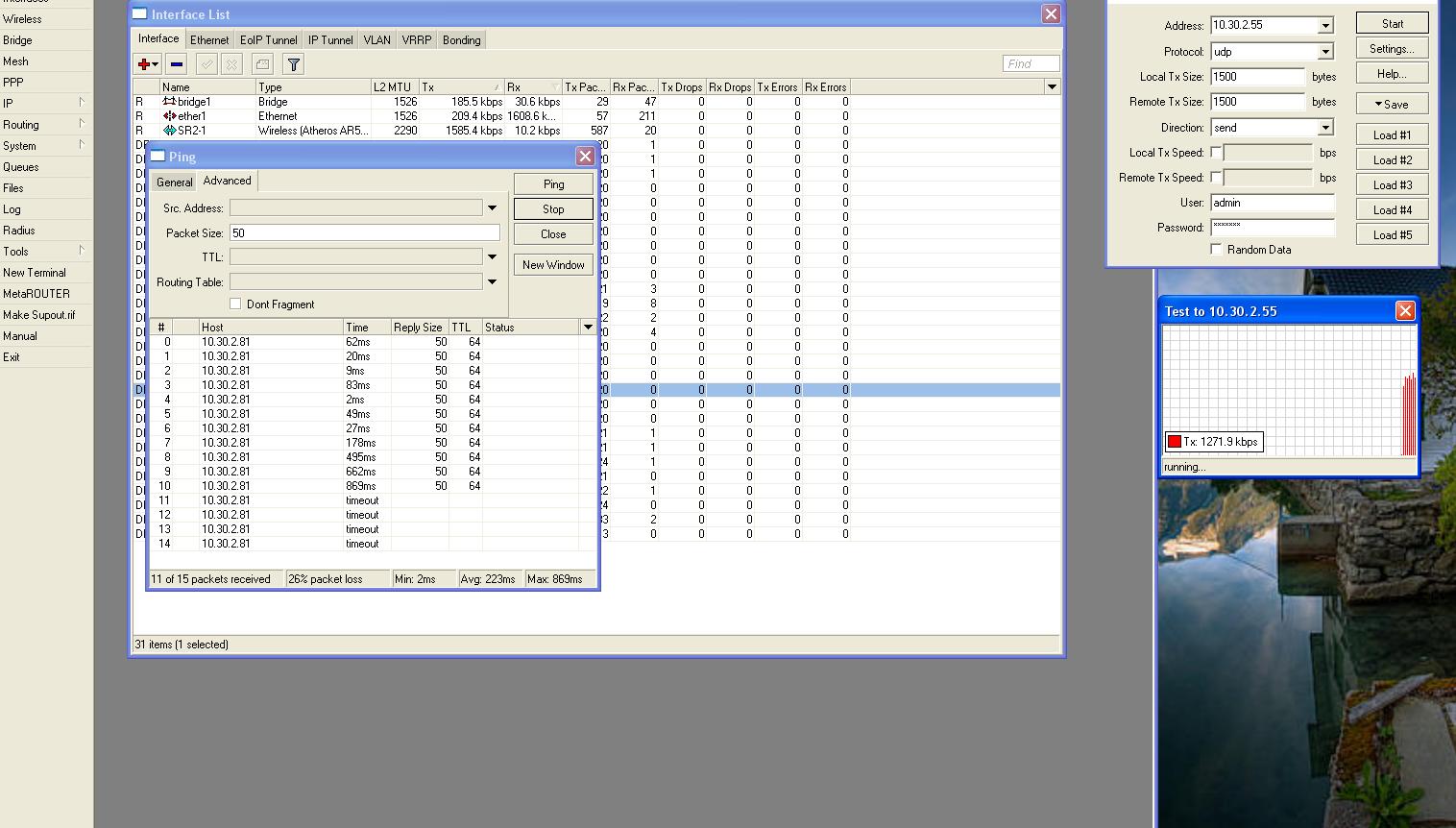

If any single client is down loading their max 1.3mbps then the latencies go up to 1-2 seconds and no other through put is available to any other client. Ap’s total traffic is maxed at about 1.5mbps
If clients are limited to down loading at 1 or 1.2 mbps latency is typically under 30ms until the AP hits about 5mbps when the latency jumps to 200ms +. AP appears to max out at 6-7mps. Tested with and with out Nstreme Same results.
